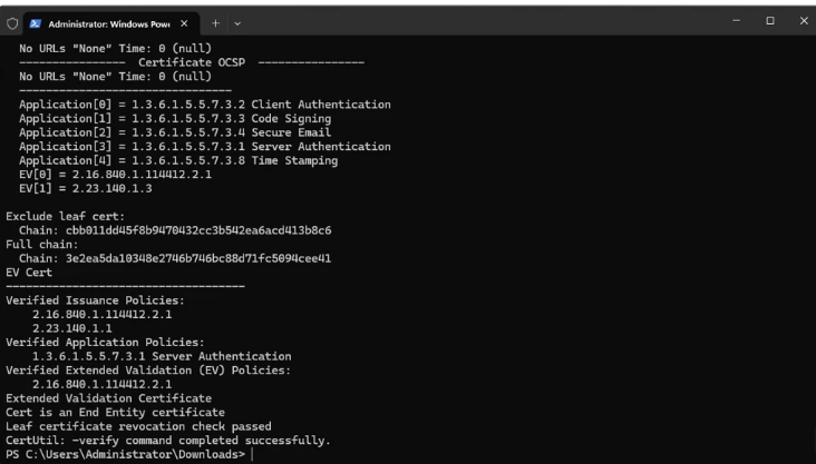

  1. Verify a certificate
    In PowerShell, execute the command:
certutil -verify %full_path_to_your_crt_file%
You should see a successful output like this:
”Leaf certificate revocation check passed” means that you’ve done everything correctly and your leaf server certificate has been successfully verified.
