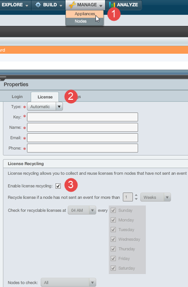

  1. On the SEM Web console menu bar, navigate to Manage > Appliances.
  2. In the Properties pane, click the License tab.
  3. Select the Enable license recycling check box, and then set the frequency according to your requirements.
Note: Frequent recycling of licenses may result to legitimate nodes having their license recycled while they are off. The normal frequency is to keep the license from two to four weeks. This is to avoid recycling a license on a node that has been off for a number of days.
