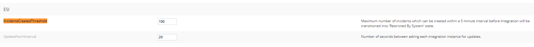

  2. Enter the following URL to open the advanced configuration page:
    http://<hostName>/Orion/Admin/AdvancedConfiguration/Global.aspx
  3. Locate the setting IncidentsCreatedThreshold and increase it to your desired value.
  4. Click Save at the bottom of the form.

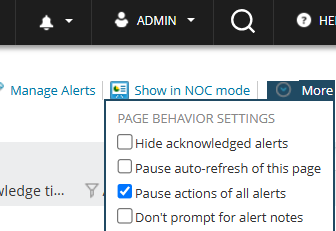

Common scenarios where SolarWinds generates Alerts could be when restarting SolarWinds where alerts were previously paused. This can be done on the SolarWinds Web Console at Alerts & Activity > Alerts > More: Pause actions of all alerts

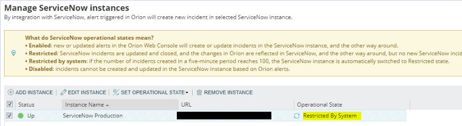

The Operational State can be updated by going to:
Settings > All Settings > Manage Alert Integration Instances
Then select the SN instance you are using, click "Set Operational State" and set it to "Enabled".  This can be useful when the state is in "Restricted" Operational State.
