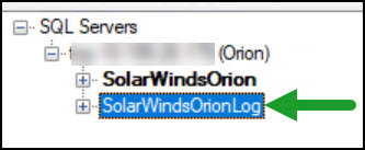

  • Check to see if there is a separate Log database using Database Manager

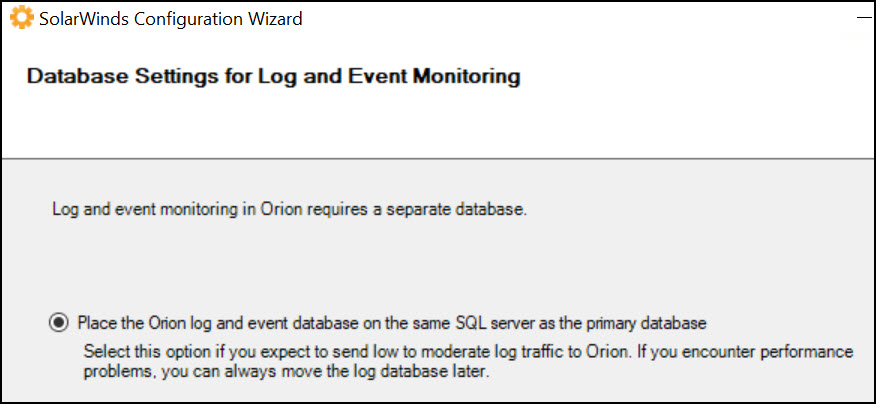

  • Open the Configuration Wizard on the polling engine if there is an OLM database section
