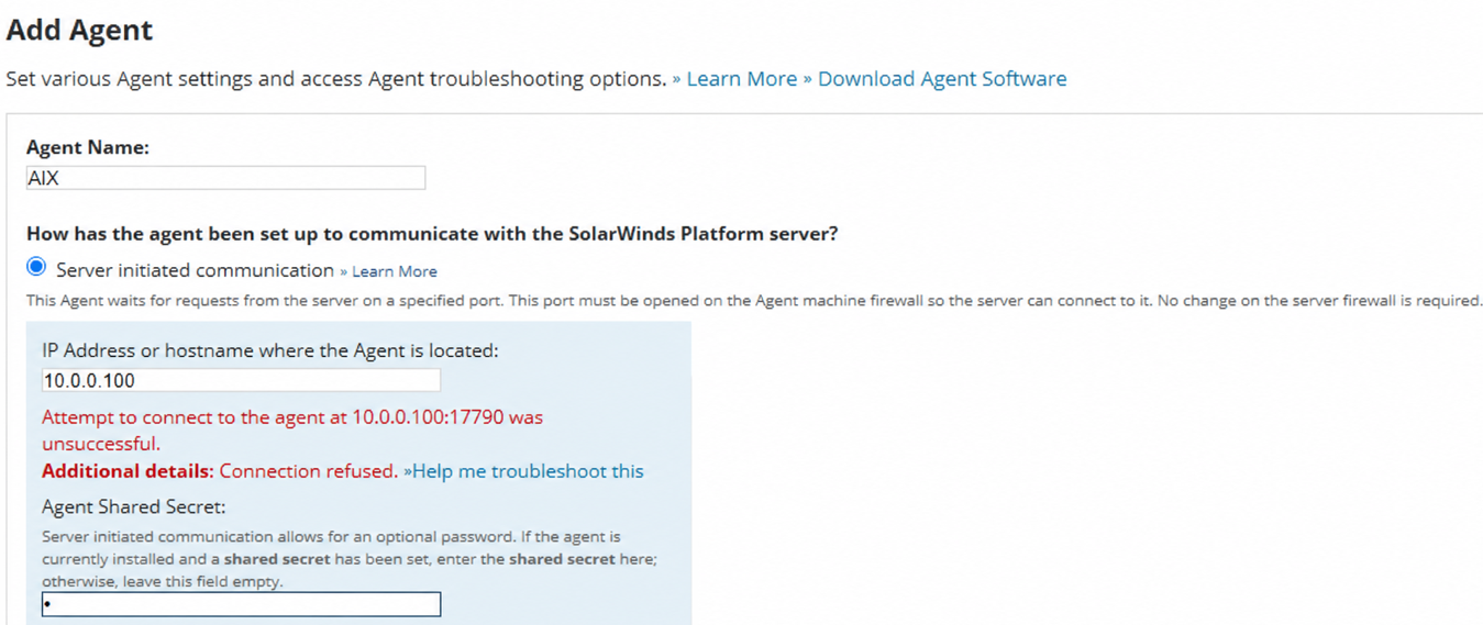

The figure below shows a generic representation of the Add Agent dialog where a server-initiated agent with a shared secret fails with a "Connection refused" message.
Figure 1: Add Agent page with Server initiated communication selected. When the agent uses a shared secret that contains an unsupported special character, the connection fails with "Attempt to connect to the agent at 10.0.0.100:17790 was unsuccessful. Additional details: Connection refused."
