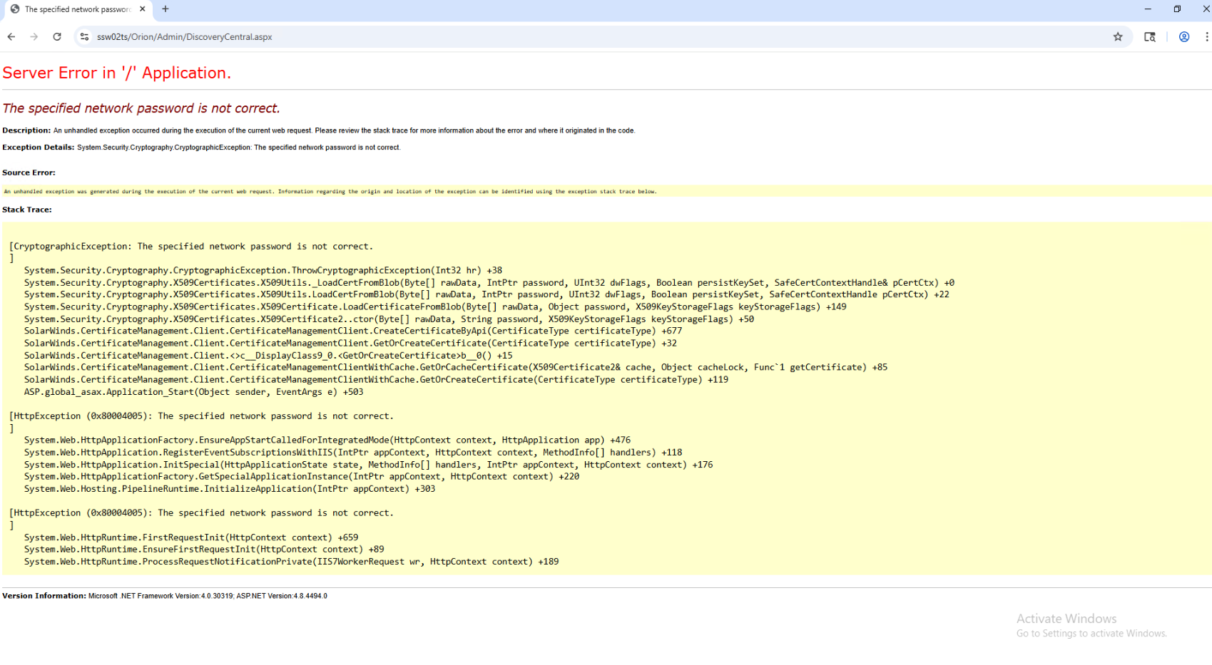

After upgrading to SolarWinds Platform 2025.2, the web Console page may display the following error message when turning off the Custom Errors in the web.config file
Server Error in '/' Application.
The specified network password is not correct
Note:
The error message "The specified network password is incorrect" can be misleading. This message is generated by the IIS service, not by the authentication system itself.
In Hybrid Cloud Observability (HCO) 2025.2, a new feature was introduced that utilizes a "SolarWinds Website Client" certificate, which is tied to the IIS Application Pool identity: IIS APPPOOL\SolarWinds Orion Application Pool.
Orion Platform
This error may occur if the system user profile folder for the Application Pool identity is missing from C:\Users. This folder is essential because it stores the Website Client Certificate required for secure communication, including the "SolarWinds Website Client" certificate introduced in SolarWinds Platform 2025.2.. Without it, the certificate cannot be loaded, leading to authentication failures that surface as the misleading password error.
If the folder is missing or its contents are corrupted, the IIS Application Pool identity (IIS APPPOOL\SolarWinds Orion Application Pool) cannot load the required certificate, resulting in authentication failures and misleading error messages as seen above.

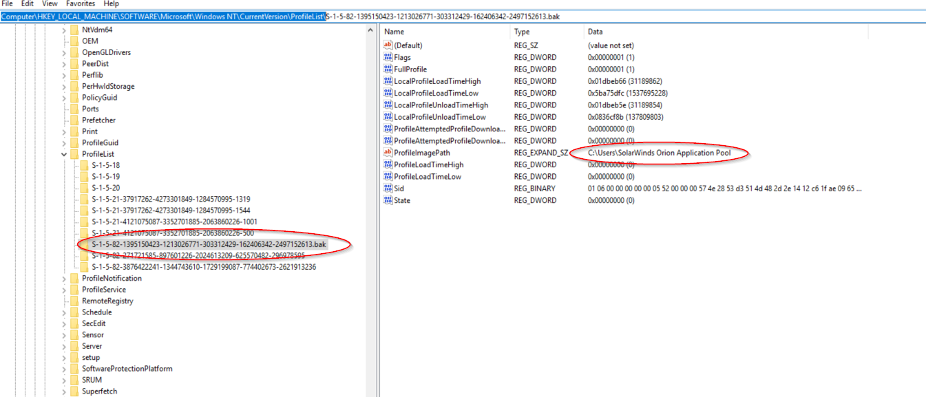

To validate, you can check this registry path:
Computer\HKEY_LOCAL_MACHINE\SOFTWARE\Microsoft\Windows NT\CurrentVersion\ProfileList\
Look into the ProfileList for SolarWinds Orion Application Pool with a .bak extension. This indicates that this profile is no longer working due to missing profile folders in C:\users.

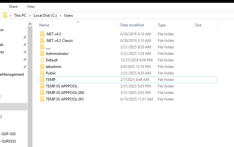

1. Open the C:\Users folder and validate if the "SolarWinds Orion Application Pool" Folder exists.
  1.  If the folder does not exist, proceed with deleting the registry entries found in this registry path:
  2. If the folder exist, proceed with deleting the registry entries in the registry path as seen in step a. Once the the registry entry removed, reboot the server then delete the "SolarWinds Orion Application Pool" folder in the c:\users.
3. Run the Configuration Wizard and allow the operation to complete successfully.
4. After the Configuration Wizard completes, verify the C:\Users directory to confirm that the 'SolarWinds Orion Application Pool' has been created.
