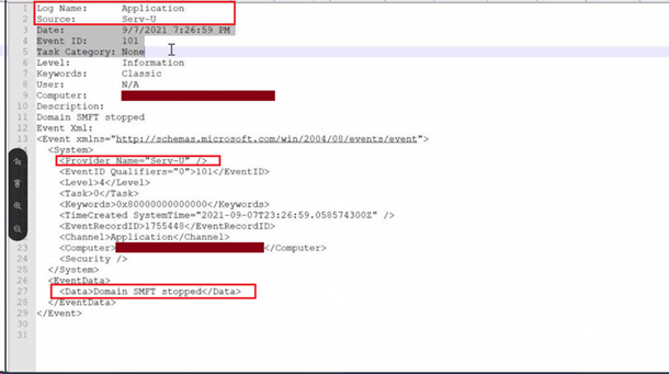

From the Event Logs:
2. Serv-U Application is crashing, error messages below:
Faulting application name: Serv-U.exe, version: 15.2.4.1324, time stamp: 0x6107b03e
Faulting module name: myodbc8a.dll, version: 8.0.26.0, time stamp: 0x60d88288
Exception code: 0xc0000005
Fault offset: 0x000000000003b033
Faulting process id: 0x1424
Faulting application start time: 0x01d7a4ca7e674021
Faulting application path: C:\Program Files\Serv-U\Serv-U.exe
