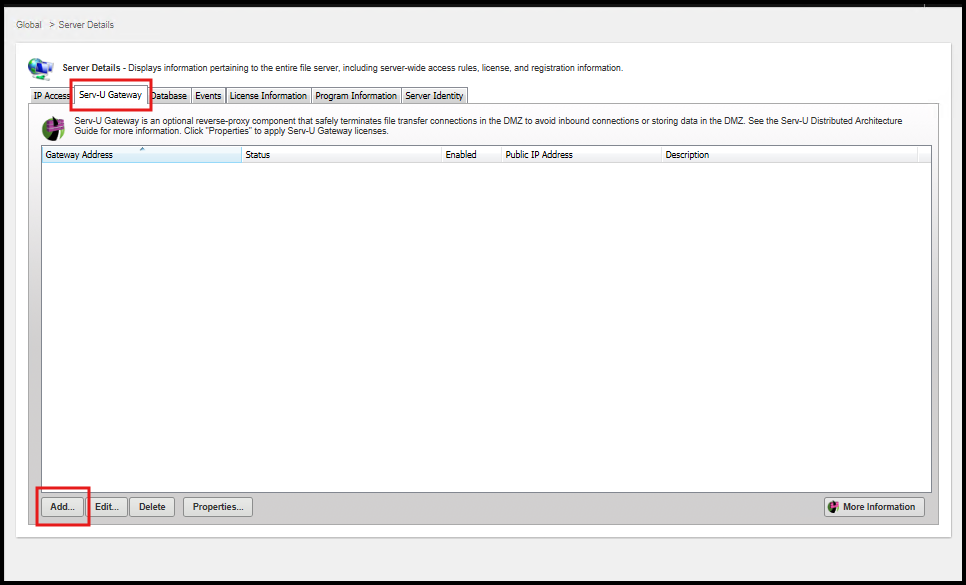

Add Gateway Entries
Almost all Serv-U Gateway configurations are performed through the Serv-U Management Console. Serv-U Gateway does not have its own management console.
Only perform this step if you are testing Serv-U Gateway on a machine without a public IP address.
To force your Serv-U Gateway to listen on a private address:
  1. Open the Serv-U Management Console and navigate to Server Details > Serv-U Gateway tab.
  2. Click the "Add" button to create a new Gateway entry.
    • Gateway Address: the IP address of your Serv-U Gateway machine.
      (If this machine has multiple addresses, pick the internal address that Serv-U will use to connect to the Gateway, not an external address that end users would access from the Internet. e.g., use "10.3.4.4", not "67.52.42.106")
    • Port: 1180
      (Leave alone for now.)
    • Public IP Address:
      (You may narrow this to only one binding later, but leave it blank for now.)
    • Enable Gateway: CHECKED
      (You may toggle this setting later, but leave this on for now.)
    • Description:
      (Leave blank or put anything you want in here.)
  3. After you click Save, the new Gateway should immediately show up in the list. Pay attention to the color of the icon.
    •  Great! Go to the next step.
    •  Serv-U is checking on the Gateway's status. Another status will appear in a few seconds.
    •  The Gateway is working but you are running dangerously close to the end of your trial or updates/support period. You should plan to buy or renew soon, but you may also move on to the next step for now.
    •  Something is wrong. Select the Gateway entry and then select "Properties" to find out why you cannot connect to your new Gateway.
      If you "fix" something (e.g., open a firewall port, start or stop Serv-U Gateway service) it will normally take a few seconds for Serv-U to realize that a change has been made. To speed up the process, select your Gateway entry, Edit it, and immediately Save your Gateway settings again.

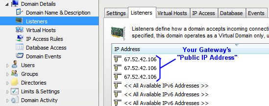

Add Listener Entries
You must add Listener entries to each domain that will use your new Gateway.
  1. Go into one of your Serv-U domains and open "Domain Details | Listeners".
  2. Before you add any Gateway Listeners, use an FTP client or web browser to sign on to one of your existing Listeners.
    The reason you want to do this now is to make sure that the user you will use to test your Gateway has been enabled, has access to the right materials, hasn't been locked out, etc. Make sure you test against one of the IP addresses on your existing Serv-U server, not the Serv-U Gateway.
  3. Click the "Add" button to create a new Listener entry.
    • Type: Select the same type as the local Listener you just tested.
      (Again, this ensures that server configuration is not the issue if you encounter problems during testing.)
    • IP address: Select an IP address on your Serv-U Gateway. Use an external or "Internet-facing" address if possible.
      (Use an internal address on the Serv-U Gateway only if you cannot test from "outside the firewall".)
    • Port: Use the same port as the Listener you just tested.
      (Exceptions: Use a port other than "22" if you are testing SFTP on a Gateway deployed on Linux. Also, use a different port if you are testing Gateway on the same machine as Serv-U.)
    • Enable listener: CHECKED
    • PASV IP Address (FTP/S only): Leave blank for now.
      (You may need to adjust this later, but work on basic connectivity first.)
  4. After you click "Save", the new Listener should immediately show up in the list. Pay attention to the icon.
