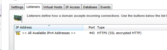

There will be instances where one of these domain listener ports will have a yellow mark indicating that there are port conflicts that will cause the ports to not accept connections.

  • Disable the Serv-U port listener from the Domain Listeners tab
  • Run a netstat command to see if the problem port is listening. Sample commands are:
netstat -ano | findstr :443 (for Windows)
netstat -ano | grep :22 (for Linux)
  • Check the PID of the listening ports and compare it from Task Manager or Resource Monitor (for Windows)
