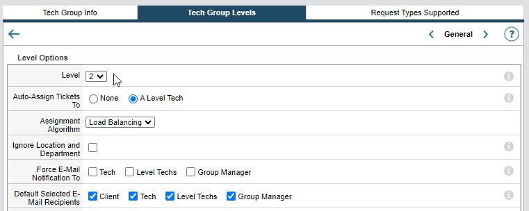

If a Tech Group manages the Request Type:
  1. Go to Techs > Tech Group > Select or Create a Tech Group and Identify which Request Types are Supported.
  1. Click the Group you want to modify, then go to a Tech Group Levels Tab, and select or create a Level:
​​​​​​​WHD_Group_Levels.png​​​​​​​
  1. On the Setting of the Group Level, modify the "Default Selected E-Mail Recipients" to select recipient.

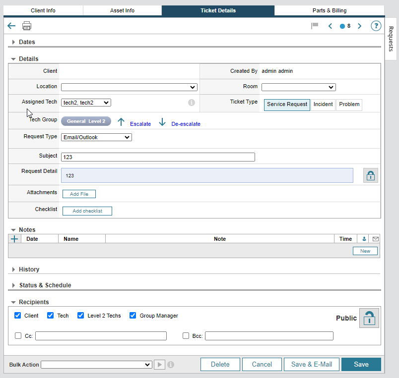

  1. If a Ticket was created under the Request Type and Group Level, that you configured on your Tech Group, the settings you made will reflect.
