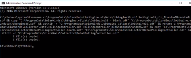

  3. Run the command prompt as Administrator and execute the command below to replace both the Job Engine and Collector SDF files:
rename c:\ProgramData\SolarWinds\JobEngine.v2\Data\JobEngine35.sdf JobEngine35_old_%random%%random%.sdf && copy "C:\ProgramData\SolarWinds\JobEngine.v2\data\JobEngine35 - blank.sdf" "C:\ProgramData\SolarWinds\JobEngine.v2\data\Jobengine35.sdf" && attrib -r "C:\ProgramData\SolarWinds\JobEngine.v2\data\JobEngine35.sdf" && rename c:\ProgramData\SolarWinds\Collector\Data\PollingController.sdf PollingController_old%random%%random%.sdf && copy "C:\ProgramData\SolarWinds\Collector\Data\PollingController-blank.sdf" "C:\ProgramData\SolarWinds\Collector\Data\PollingController.sdf" && attrib -r "C:\ProgramData\SolarWinds\Collector\Data\PollingController.sdf"
