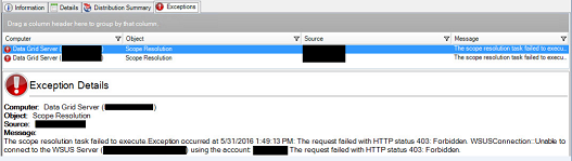

The following error is recorded in the Patch Manager Task History:
Exception Details
The scope resolution task failed to execute. Exception occurred at <date, time>. The request failed with HTTP status 403: Forbidden. WSUSConnection: Unable to connect to the WSUS Server (server name) using the account (account name). The request failed with HTTP status 403: Forbidden.
