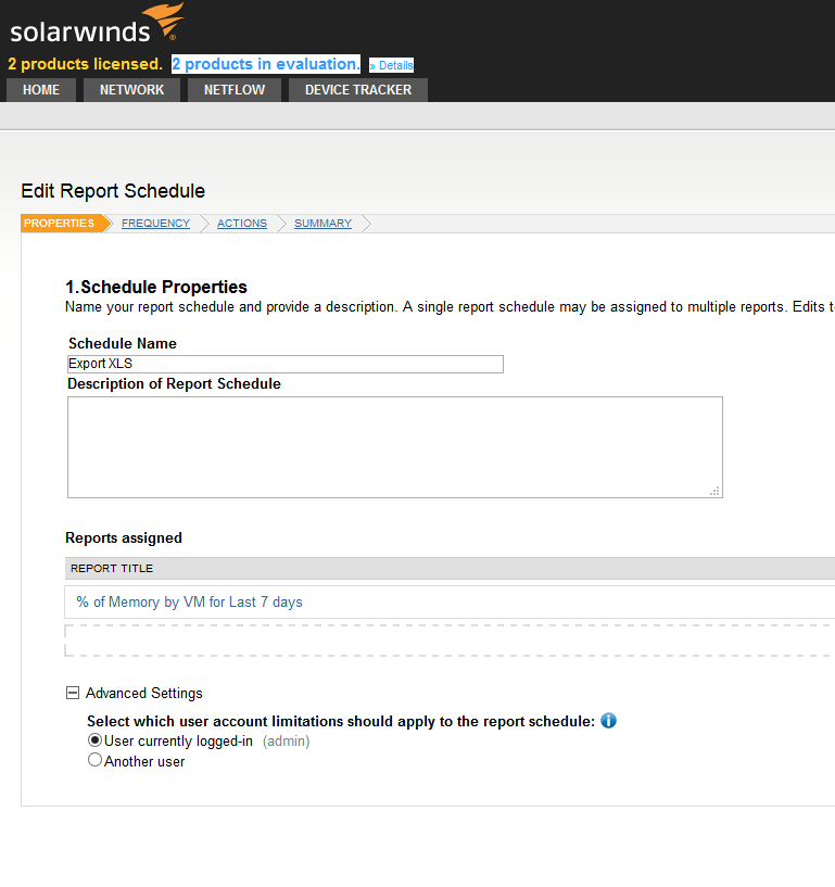

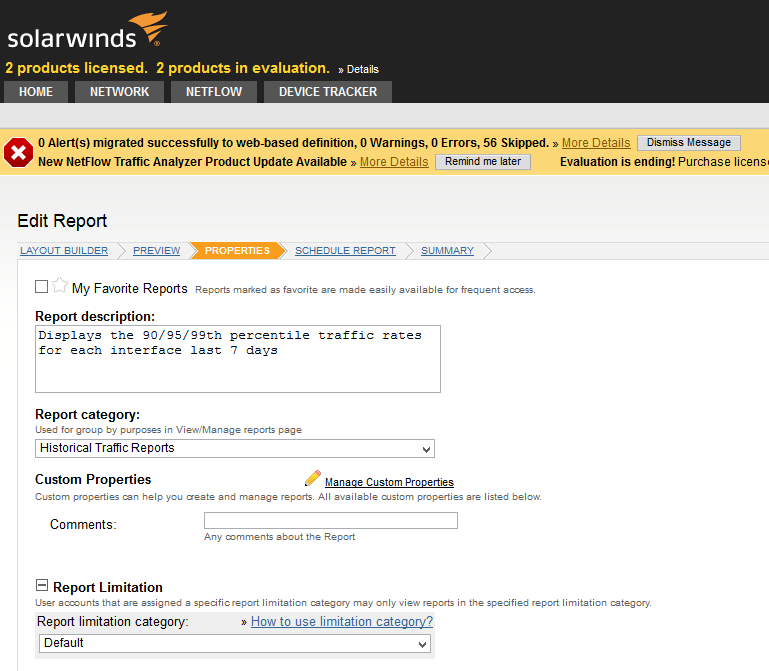

  1. Go to the Orion Web Console and edit the report.
  2. Under Properties, check the report limitation.
  3. Go to Manage Reports > Schedule Manager > Edit Report Schedule.
  4. Expand the Advanced Settings. Take note of the user of the exporting job.
  5. Go to Settings > Manager Accounts, then select the account from the previous step.
  6. Edit and check the report limitation applied to the account.
  7. If there is a mismatch between the report and account limitations, the following options can resolve your issue.
    Change the Report Limitation to Default.
    Change the user limitation to Tech.
    Create a new user with limitation of Tech and assign that user to Schedule Manager to export the report.
