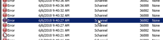

You have successfully installed Patch Manager and deployed Patch Manager agents, but the default GPO does not trust the Eminentware CA cert and returns Schannel errors every minute in the Windows security event log.
Patch Manager
  • Error:  Schannel certificate Error 3688*

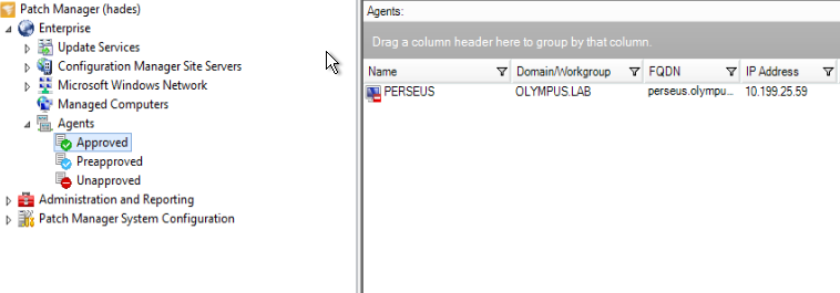

  2. Check the Agent bucket on the Patch Manager Server

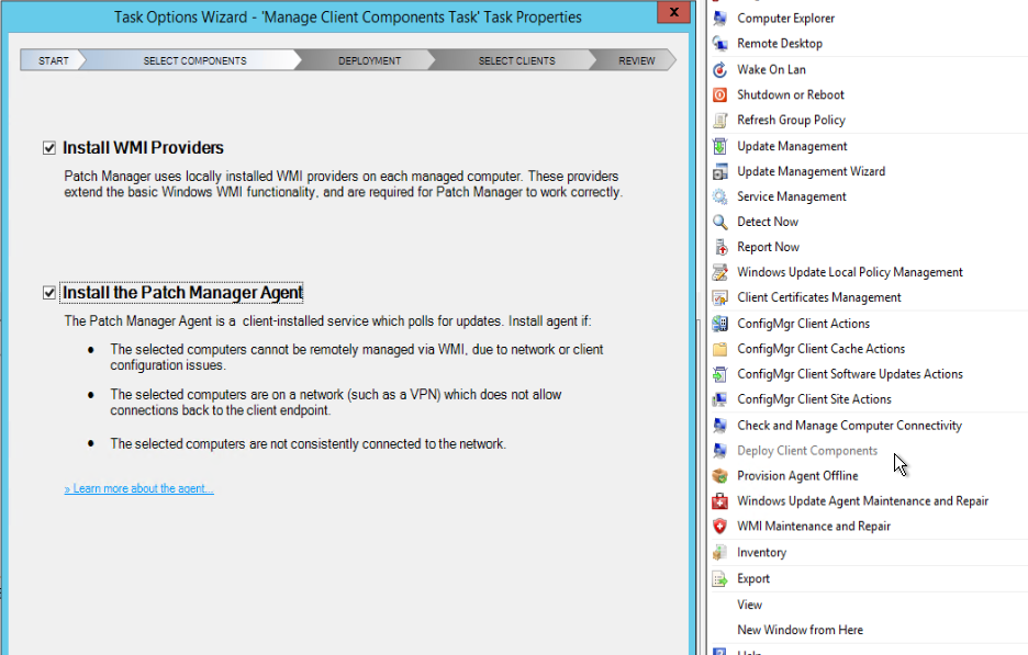

  3. If the Agents are no longer listed please uninstall or reinstall the Agent if needed to recreate the certificate.
