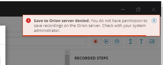

"Failed to execute SWIS verb: Error: Request failed with status code 403" when saving WPM Recording for SolarWinds Platform 2022.2 and below
Save to the Orion server denied. You do not have permission to save recordings on the Orion server. Check with your system administrator. User is unable to save recordings. WPM Recorder access denied, not saving, unable to authenticate. Failed to execute SWIS verb: Error: Request failed with status code 403

User is unable to save recording In the WPM Recorder. User receives below error:
