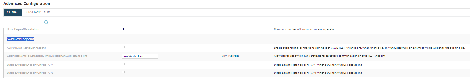

Steps to Re-enable the Old Port:
  1. In http://OrionHostname/Orion/admin/AdvancedConfiguration/global.aspx, configure the following settings:
    • Set CertificateNameForSafeguardCommunicationOnSwisRestEndpoint to SolarWinds-Orion
    • Uncheck DisableSwisRestEndpointOnPort17778
Example Screenshot:
  1. Click SAVE
