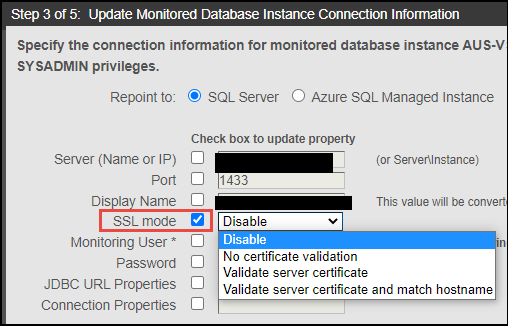

    • If the MS JDBC driver is used, the SSL mode drop-down menu is shown:

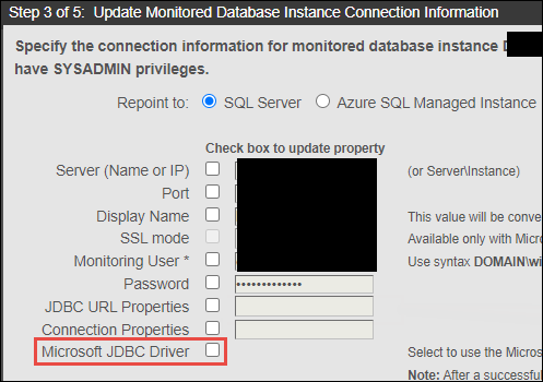

    • If the jTDS driver is used, the SSL mode drop-down menu is not shown, but the Microsoft JDBC Driver option is there to allow you to change drivers:

On the Update Monitored Database Instance Connection Information page, select the appropriate SSL mode option, depending on how restrictive the settings are for SSL on your server. The options (from least to most secure) are:
  • Disable
  • No certificate validation
  • Validate server certificate
  • Validate server certificate and match hostname
For more information about these options, see Register a SQL Server instance.
Note: If the ForceEncryption flag is set to Yes on the SQL Server database instance, all communication with the instance must be encrypted. Do not choose Disable as the SSL mode.

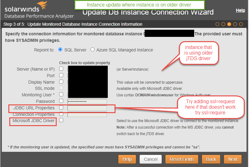

On the Update Monitored Database Instance Connection Information page, update the connection information to get DPA to request the SSL connection. In the JDBC URL Properties, and add the following:
ssl=request
If there are other entries in this field, you can add this with a semicolon as a separator. For example:
NTLMv2=true;ssl=request.
If this does not resolve the issue, enter the following property instead:
ssl=require
