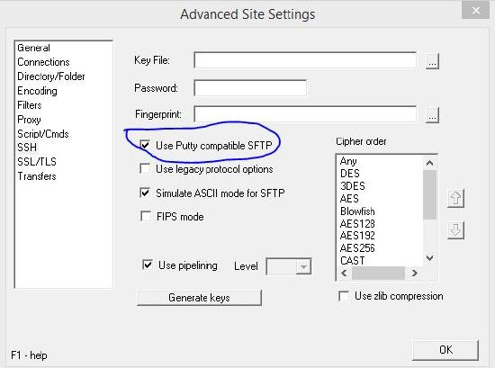

The SSH Protocol Error: < Invalid state for the command > usually happens in CoreFTP if the "Use Putty compatible SFTP" option is not selected. Serv-U MFT.
10/29/2018 2:18 PM
10/29/2018 2:18 PM
This error usually happens in CoreFTP if "Use Putty compatible SFTP" is not selected.
1. Check the FTP client configuration to verify if the correct protocol is set for SFTP.
2. If this is CoreFTP, navigate to advanced settings > SSH.
3. Check the box "Use Putty compatible SFTP".
4. Reconnect to SFTP.
