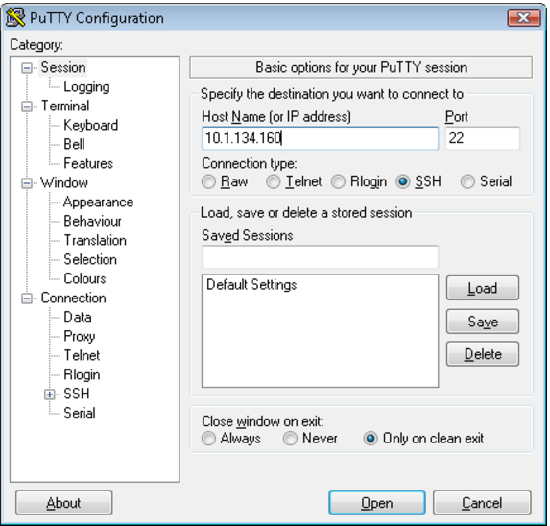

The 3PAR provider must be enabled before it can be added to SRM. The following example shows how to use PuTTY to access and configure the 3PAR SMI-S provider.
Log into the 3PAR Command Line Interface (CLI) using PuTTY
  1. Using SSH, enter the IP address of the 3PAR array:
  2. Log in using the username and password setup on the array. The defaults are 3paradm/3pardata.
  3. Enter setcim. This command can be used to start or stop the provider.
