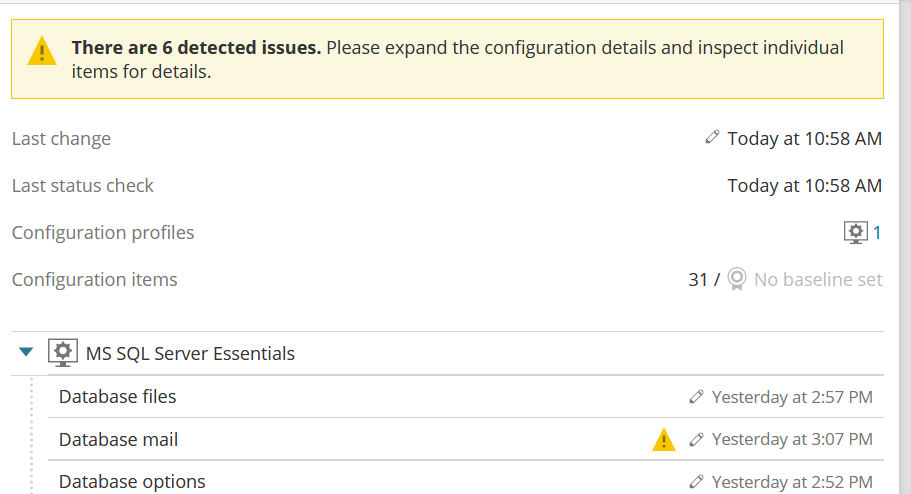

1. On "Poll Now" on "Server Configuration" results in issues on assigned SQL Essentials profile:

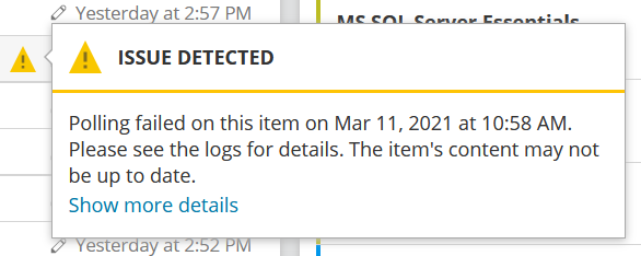

2. Mouse-over on Database mail:

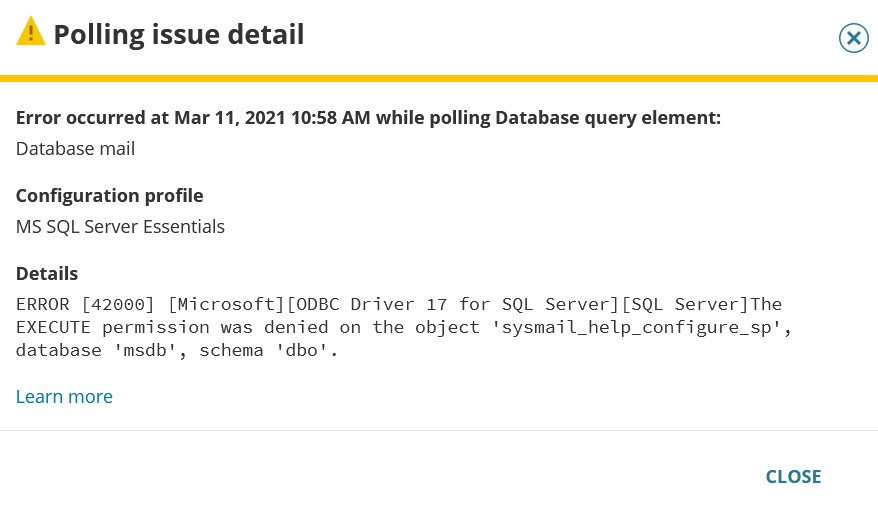

3. Clicking on "Show more details" resulted in the following:
4. In this case:
ERROR [42000] [Microsoft][ODBC Driver 17 for SQL Server][SQL Server]The EXECUTE permission was denied on the object 'sysmail_help_configure_sp', database 'msdb', schema 'dbo'.

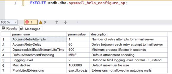

1. Using 'sa' permissions, running the Stored Procedure returns data:

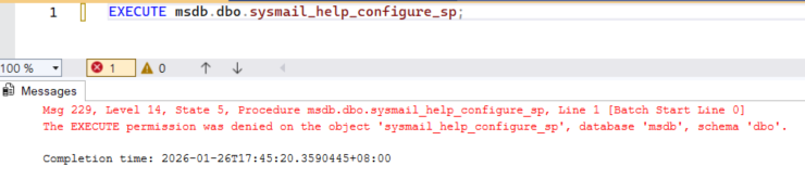

2. But running in another SQL user:
3. Reference to MS KB - https://docs.microsoft.com/en-us/sql/relational-databases/system-stored-procedures/sysmail-help-configure-sp-transact-sql?view=sql-server-ver15
4. The user that is querying the Stored Procedure does not have GRANT permissions
