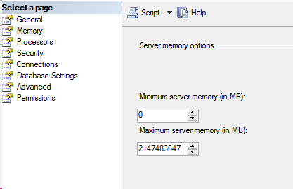

In the Left pane tree, right-click on  Server instance > Go to Properties > Memory.
Below you can see a default memory limit configuration consuming all available RAM memory.

  • SQL server default configuration.

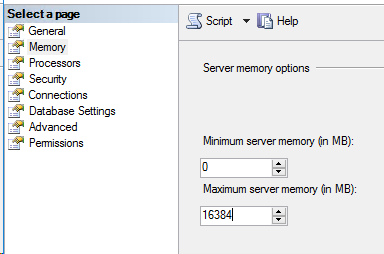

  • Here you can specify a Max and Min Limit.
  • In the example below, you can see 16 Gb of memory limited by SQL
  • This leaves 4 Gb for OS (If OS has 20 Gb)
