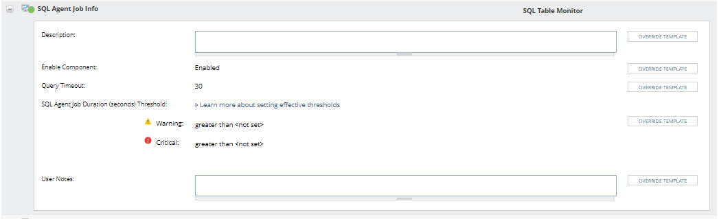

  1. Open the SolarWinds Platform Web Console.
  2. Go to Application Details page for the AppInsight for the target SQL Instance.
  3. Edit the Application Monitor.
  4. Find SQL Agent Job Info, and set it to  Enabled.
