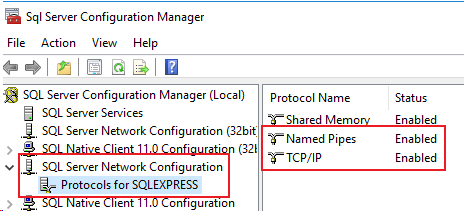

  1. RDP to the SolarWinds Platform database server.
  2. Run the SQL Server Configuration Manager.
  3. Navigate to SQL Server Network Configuration > Protocol for [Database].
  4. Ensure that the Named Pipes and TCP/IP is set to Enabled:

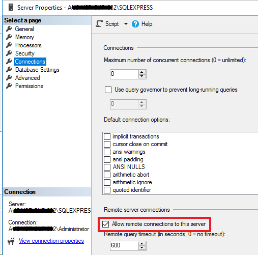

  8. Run the SQL Server Management Studio.
  9. Right-click the SQL server, select properties and go to the Connections tab.
  10. Ensure that 'Allow remote connections to this server is selected:
