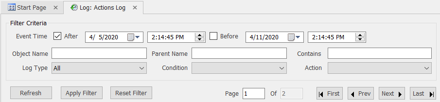

  1. Check the Actions Log and filter it to ensure the Condition in question was triggered.image.pngimage.png

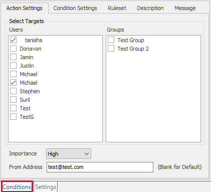

  3. Review the Action Settings for the Condition(s) in question to cross reference recipients to receive the alert between the Users and/or Groups Configurations. For example, if you have 3 recipients for a triggered alert that displays in the Actions Log that were supposed to receive an email alert, you can perform a few tests by checking each recipient individually with any Condition you are comfortable with triggering intentionally for testing purposes. Using my example of 3 recipients, you would perform 3 individual tests against the same Condition against each recipient separately and then compare results for each test to see if any one of the recipients received it when configured by itself to narrow down to the problematic recipient.image.png
