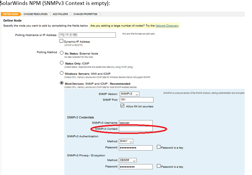

The device is responding to SNMPv3 request with some Context Name, which is not been sent by SolarWinds NPM. Therefore, when the information is returned under SNMPV3 packet its been rejected by the SolarWinds Platform .

Resolution 1:
Either the Context name must be configured on the device and then fed into the SolarWinds Platform NPM SNMPv3, or the issue must be corrected by the device's Vendor.

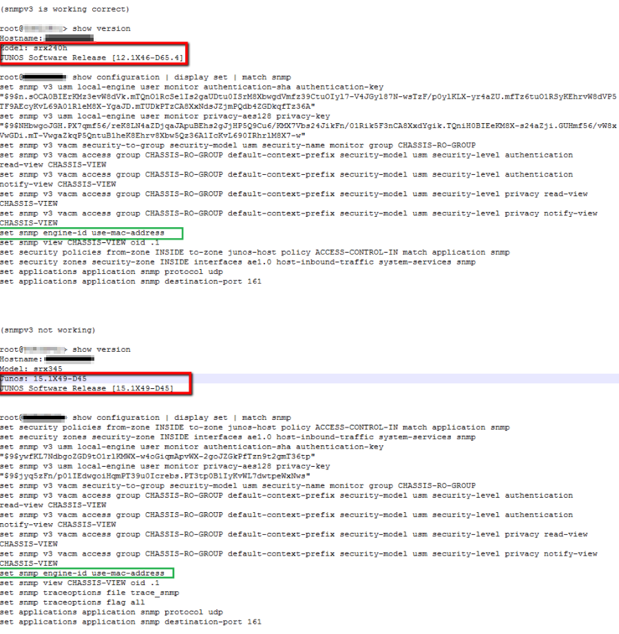

Resolution 3:
Scenario: Another device already added to the SolarWinds Platform via SNMPv3 and the customer is insisting it is identically configured with the affected node.
1. Check CollectorService.log and look for this similar error:
ERROR DataPreProcessing - Processing result: PollerResultWrapper: PollerType=N.Uptime.SNMP.Generic, NetObject=N:13 ErrorCode=79F2, ErrorMessage=Error 31218 - SNMPv3 - Wrong Digests - The authentication digest did not match to the expected result, possible incorrect key/password.
If the device is configured using Authentication-Key, it's entirely possible that the wrong one is on the affected device. Create a separate SNMPv3 account and assign that to the node and see if that works.
2. If the same issue, provide Support with screenshots on how both working and non-working devices are configured to check on the device model (JUNOS), authentication setup, and if SNMP is set up to use MAC Address for engine-id. See the sample image below:
3. Implement SNMPv3 via 'authentication-password' instead of 'authentication-key'. It will be converted automatically to 'authentication-key' by using engine-id.
