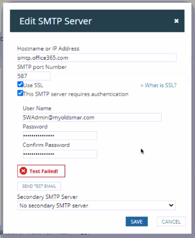

With TLS enabled

Error 3:
ERROR SolarWinds.Orion.Core.Actions.Impl.Email.EmailMethodInvoker - (null)  Test for SMTP server (smtp.office365.com:587, SSL enabled, Authentication enabled) failed
System.Net.Mail.SmtpException: Transaction failed. The server response was: 5.2.252 SendAsDenied; jane.doe@abc.com not allowed to send as john.doe@abc.com STOREDRV.Submission.Exception:SendAsDeniedException.MapiExceptionSendAsDenied; Failed to process message due to a permanent exception with message Cannot submit message.

Error 3: This error means the user whose credentials you specified in the SMTP connection cannot submit messages on behalf of the user specified in the From and/or Sender MIME headers
Solution for Error 1:
- Ensure TLS box is checked, if you selected This SMTP Server requires authentication if the your SMTP server is smtp.office365.com

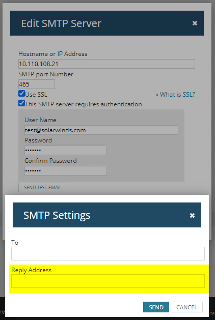

Solution for Error 2:
The user will need to specify the "Reply Address" using the same account / email address as what was used to authenticate in smtp.office365.com
Solution for Error 3:
Enter the username used while setting up the SMTP server and not a different one.
Once done, test again and it should work as expected.
