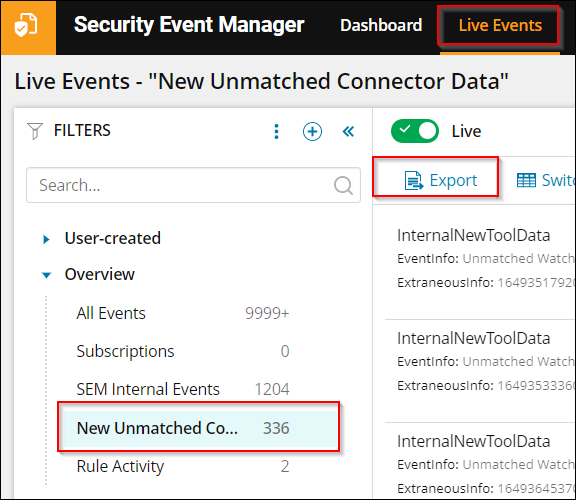

Step 1
We are using the new HTML5 events console for this process by selecting the New Unmatched Connector Data filter.
Step 2
Now with the exported csv file, contact SEM Support and if the file is over 10MB they will supply you an ftp link. If its under 10MB you can add it directly to the support case.

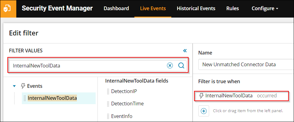

What if you do not have the filter?
If the SEM version has been continually upgraded, the filter may be missing and you may have to manually  create the filter, here is the correlation. The proceed to follow steps 1 and 2 above.
