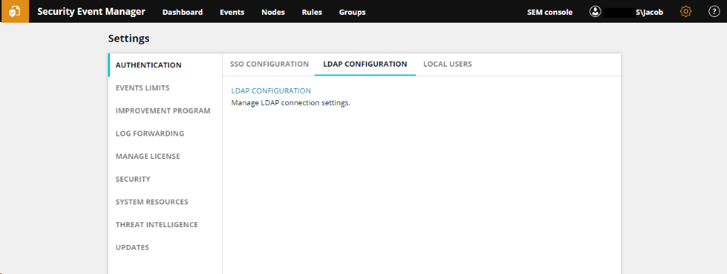

When adjusting the SEM to use LDAPS instead of LDAP it is important to enable SSL in two primary locations. One is when configuring LDAP authentication to the SEM. This can be done by going into the settings on the HTML5 web console and adjusting the "LDAP Configuration" to use SSL.

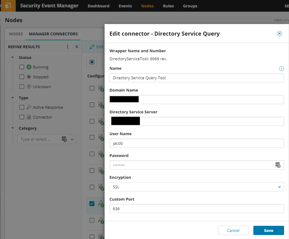

Another important place to check is in your Manager Connectors. There is a Directory Services Query connector that is sometimes set up to allow the use of Active Directory groups when applying rule logic. This also has settings to enable SSL, which will allow its traffic to traverse using LDAPS.
