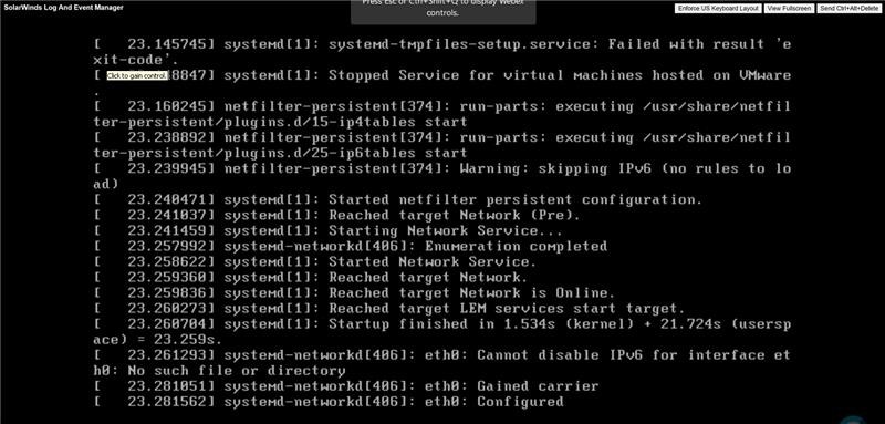

Should you encounter a SEM or LEM appliance that is giving an fsck error when booting or get stuck on either of the screens similar to below then you can use this guide to attempt to repair the file system.
Cause 1:

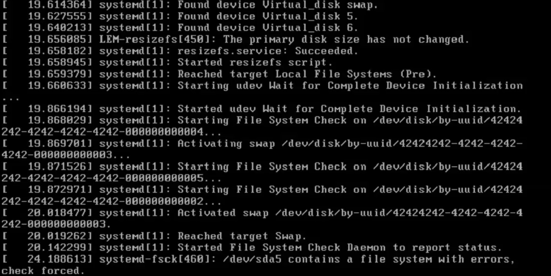

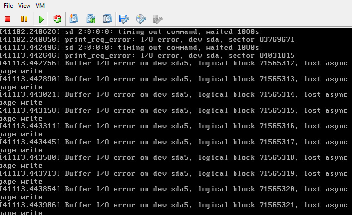

Cause 2: systemd-fsck[460]: /dev/sda5 contains a file system with errors, check forced.
Cause 3:  Buffer I/O error on dev sda5, logical block, lost async  page write
*Note: As per cause 2 screenshot, the fsck command was running on /dev/sda5. After reboot, let it run for about 30 to 50 minutes (depends on the size of the disk allocation) and see if that boots up normal.
Do note that this may not resolve the file system error and it is possible a redeployment of the appliance may be required.

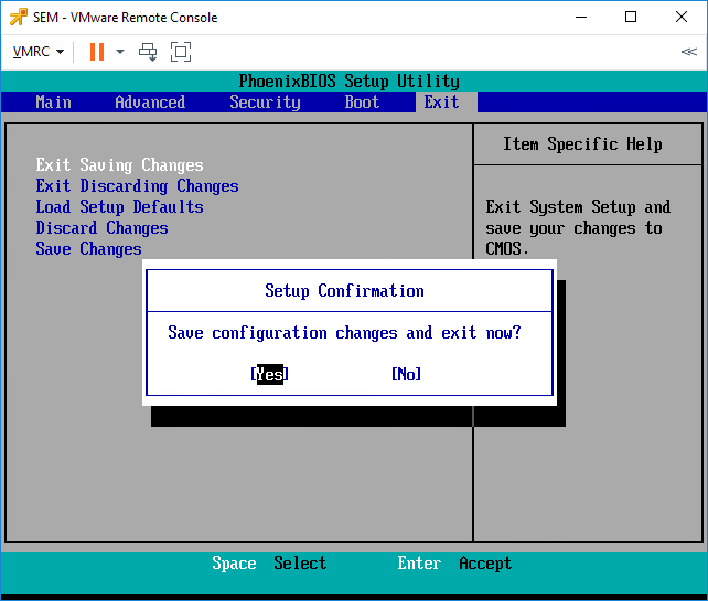

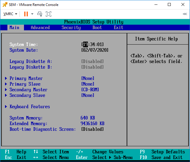

  2. Boot into the Virtual Machine BIOS

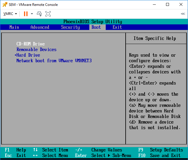

  3. Change boot order to "boot CD-ROM" first
  4. Save changes and exit the BIOS

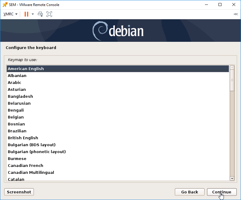

Starting Rescue Mode

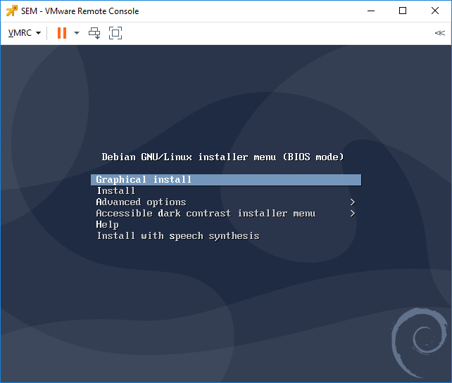

  1. Debian Installer Loads

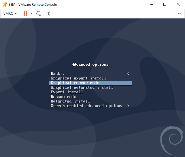

  2. Select 'Advanced Options' and hit *enter* on keyboard
  3. Select 'Graphical Rescue Mode' and hit *enter* on keyboard
Configure Rescue Mode

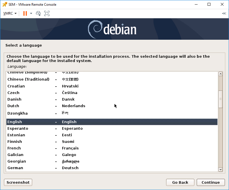

  1. On "Select Language" Select or Leave on 'English' and click *Continue*

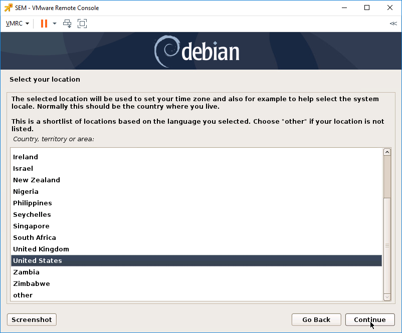

  2. On "Select Your Location" Select or Leave on 'United States' and click *Continue*
  3. On "Configure The Keyboard" Select or Leave on 'American English' and click *Continue*

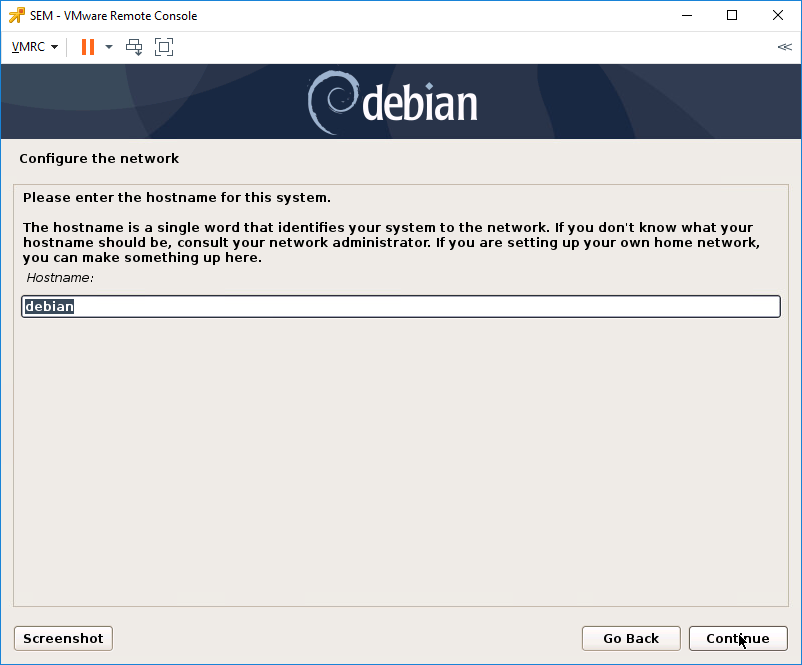

  4. On "Configure The Network" Leave hostname as-is and click *Continue*

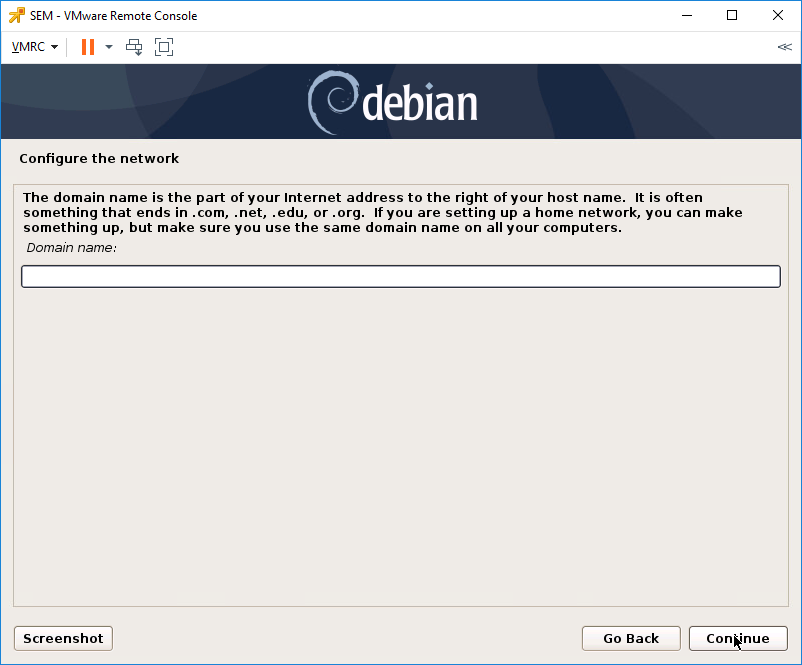

  5. On "Configure The Network" Leave domain as-is and click *Continue*

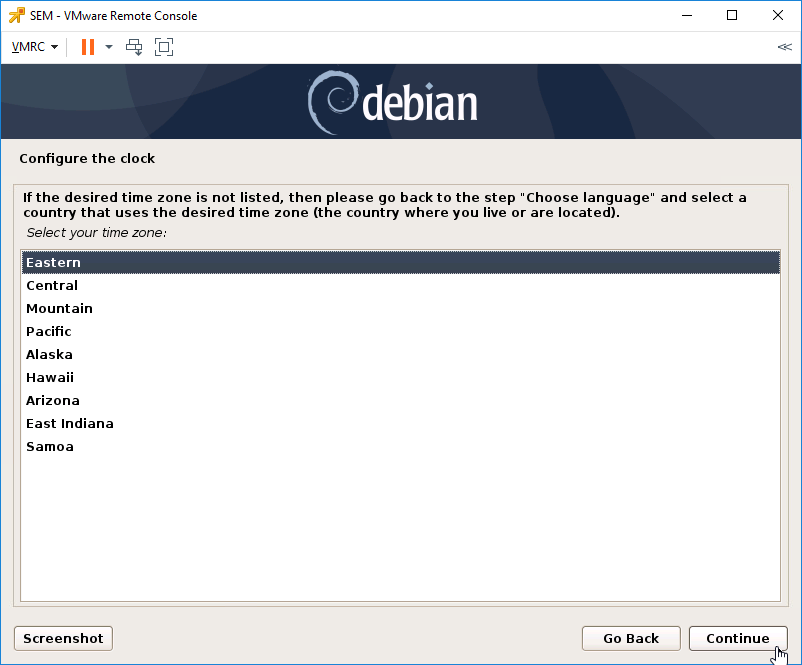

  6. On "Configure The Clock" Leave as-is and click *Continue*

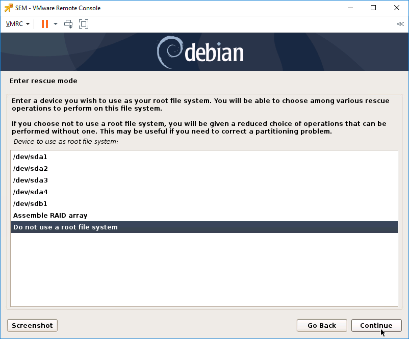

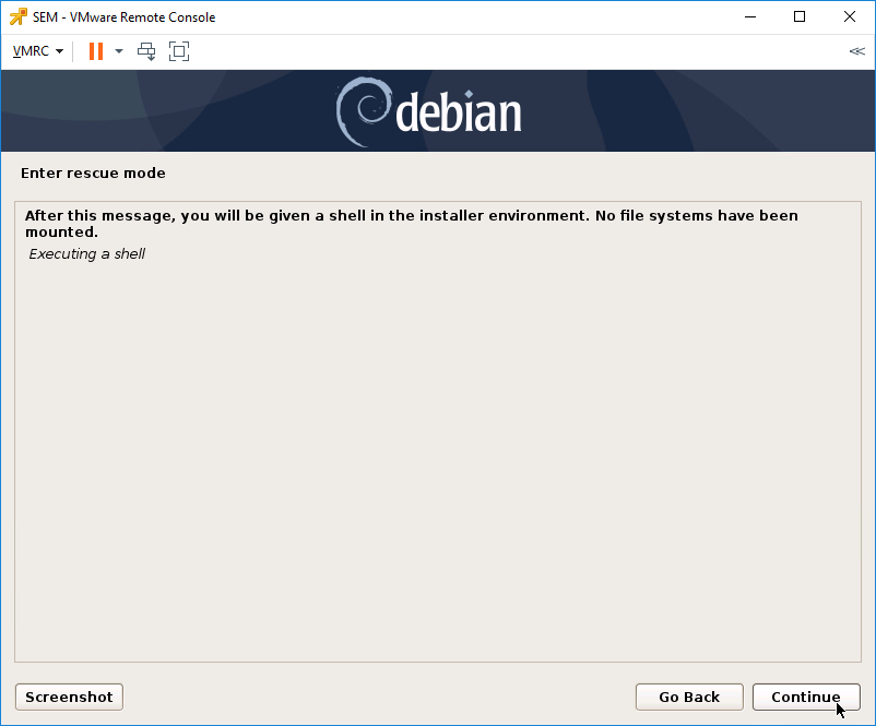

  7. On "Enter Rescue Mode" choose 'Do not use a root file system' and click *Continue*

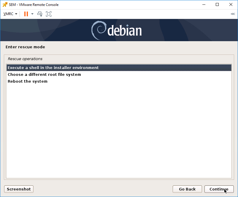

  8. On "Enter Rescue Mode" choose 'Execute Shell In The Installer Environment' and click *Continue*
  9. On "Enter Rescue Mode" Click *Continue*

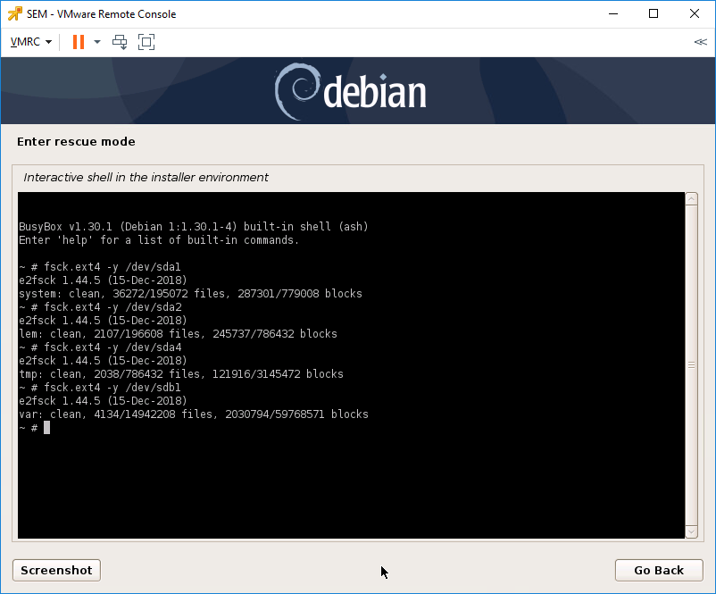

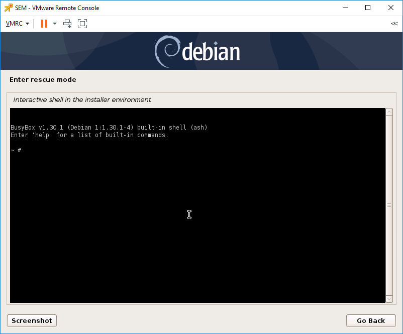

Running `fsck` in Rescue Mode
You should now have a BASH shell to run `fsck` commands in.
Depending on the disk space allocated to the Appliance its possible for the `fsck` command to take a long time to run
!!Check VM if it has 1 disk or 2 disks
Depending on which version the appliance was deployed you will need to run the following different commands:
For Dual Disk SEM (6.4 to latest):
  • fsck.ext4 -y /dev/sda1
  • fsck.ext4 -y /dev/sda2
  • fsck.ext4 -y /dev/sda4
  • fsck.ext4 -y /dev/sdb1
For Single Disk SEM (versions below 6.4 - EOL):
  • fsck.ext4 -y /dev/sda5
  • fsck.ext4 -y /dev/sda6

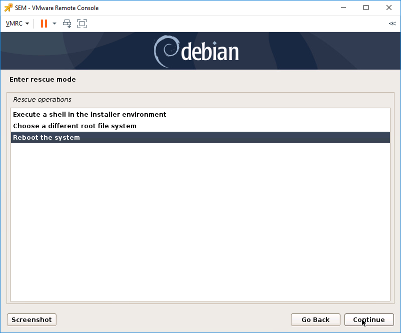

  1. Click *Go Back*
  2. Select 'Reboot' and click *continue*
