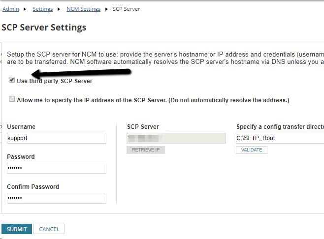

Resolution 1:
You may be able to resolve this issue by configuring NCM to utilize a Unix/Linux-based SCP/SFTP server or experimenting with third-party Windows-based SCP/SFTP servers that have been installed on the NCM server and additional polling engines, if applicable. To do this, go to Settings>NCM settings>SCP Server and check the box to "Use third-party SCP Server."
