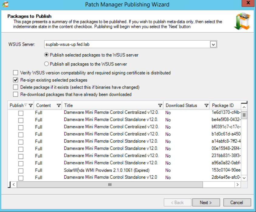

When you use the Patch Manager Admin Console to synchronize third party updates to WSUS, SCCM generates the following error:
The SCCM certificate validation failed for said third party update.
Patch Manager
  1. Log in to the Patch Manager Admin Console.
  2. In the navigation pane, expand Enterprise > Update Services > Your_WSUS_Server > Updates and select Third Party Updates.
  3. In the center pane, delete all updates with issues.
  4. Expand Administration and Reporting > Software Publishing.
  5. Locate the problem update.
  6. Right click the problematic update and select Publish Package.
  7. In the Packages to Publish window, select Re-sign existing selected packages, and click Next.
  8. Complete the wizard.
  9. Resync WSUS with SCCM.
