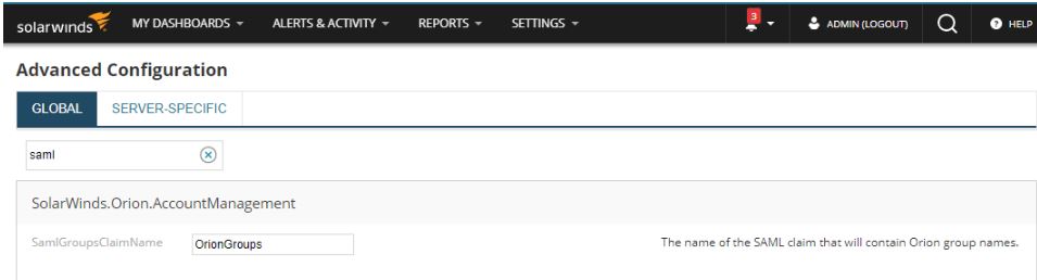

  • The Group name on the SolarWinds Platform Advanced Configuration page is "OrionGroups" as seen in SamlGroupClaimName section. These need to match.
  1. Since the user already has the group names in another claim attribute, the name of the claim carrying groups can be changed to "Group-abc" in SolarWinds Platform Advanced Configuration, under SamlGroupsClaimName.
  2. Go to http://solarwinds-server/orion/admin/advancedconfiguration/global.aspx
  3. Find SamlGroupsClaimName and change this entry to the group that was configured in SAML.

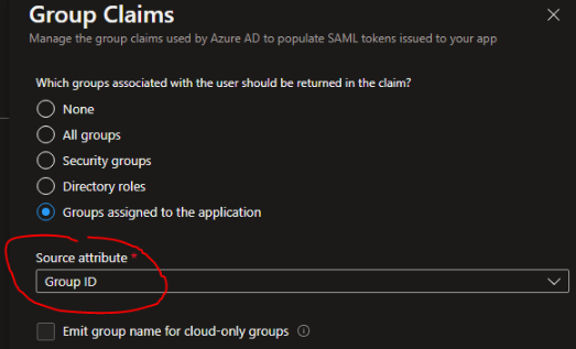

It doesn’t work with Saml account name but with Azure AD group ID. Samlaccountname is not supported in this scenario but group ID is.

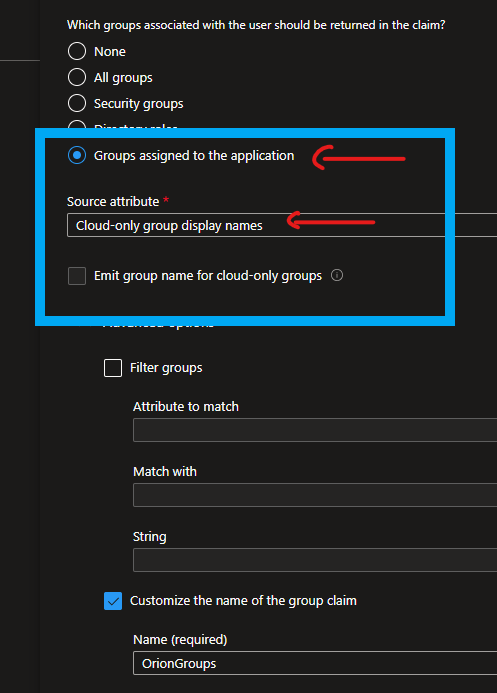

On version: 2024.4, The source attribute should be set to "Cloud-only group display names".
