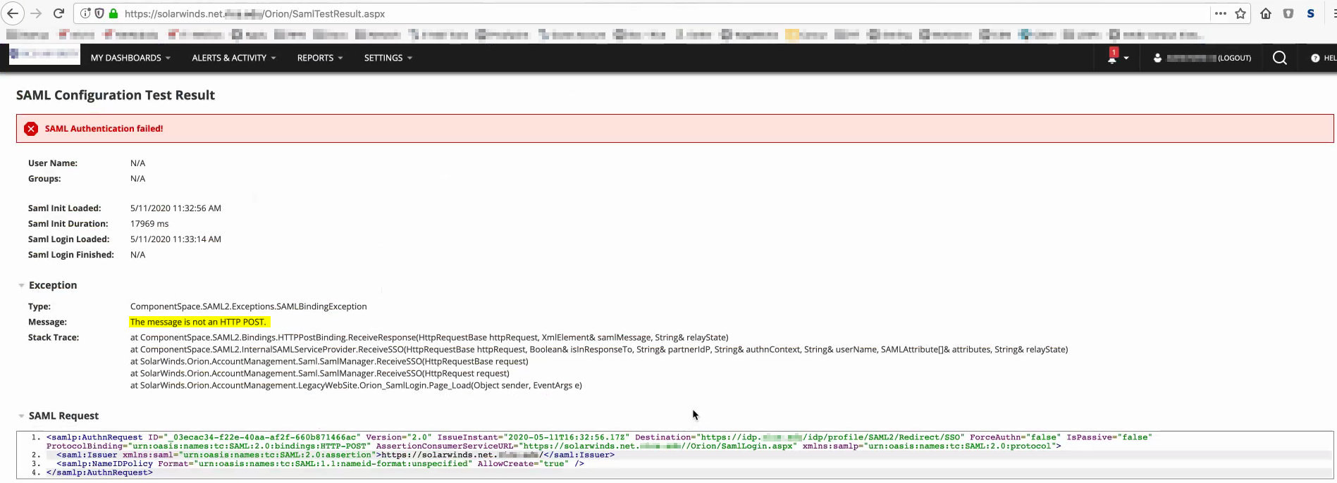

When using the SAML Configuration Test Result page, you may receive the following message:
The message is not an HTTP POST

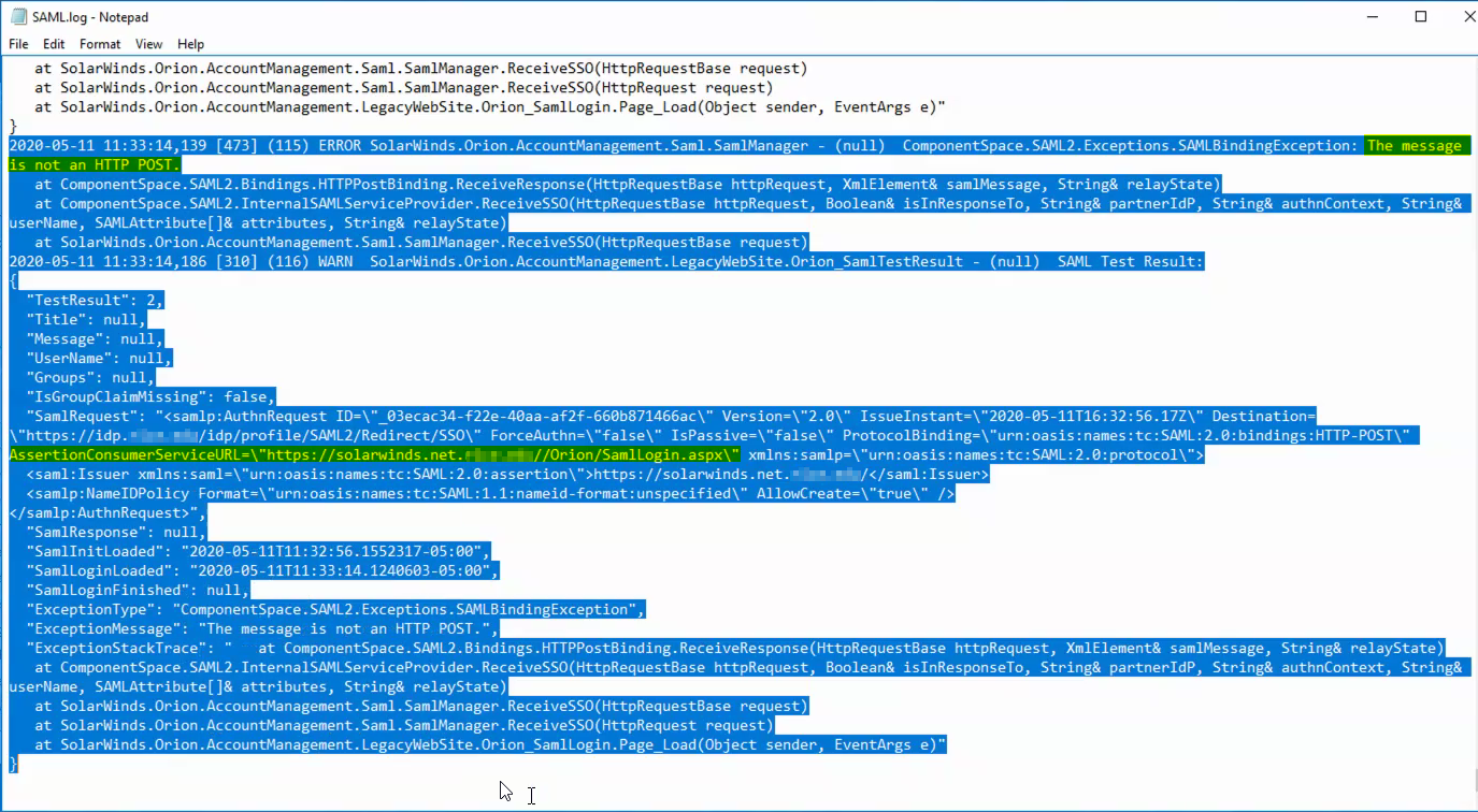

  • Seeing error logs below in SAML.log (C:\ProgramData\SolarWinds\Logs\Orion\SAML.log):

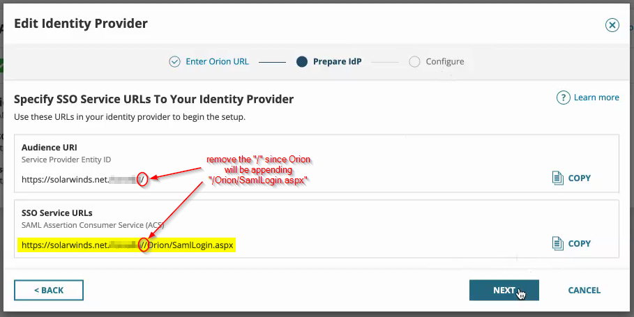

  • Audience URI should start with https://
  • Audience URI should NOT end with a /
For example, the Audience URI should be https://test.bbtest.net

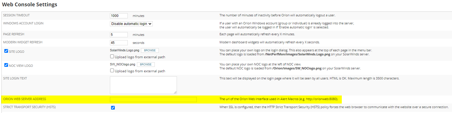

    Verify that the hostname of the server hosting your main website and/or additional website:
    1. Log in to the Orion Web Console hosted on your main Orion Platform server using an administrator account.
    2. Click Settings > All Settings, and then click Web Console Settings.
    3. Make sure that the Orion Web Server Address field is empty or that the hostname is the same as you can see on the Prepare Identity Provider page.
    4. If you have deployed additional web servers, review the additional web server hostname. Repeat steps b-c for the Orion Web Console hosted on the additional web server.
NOTE: Make sure not to append "/" for the Orion URL since Orion will be appending "/Orion/SamlLogin.aspx" for the SAML Assertion Consumer Service (ACS).
