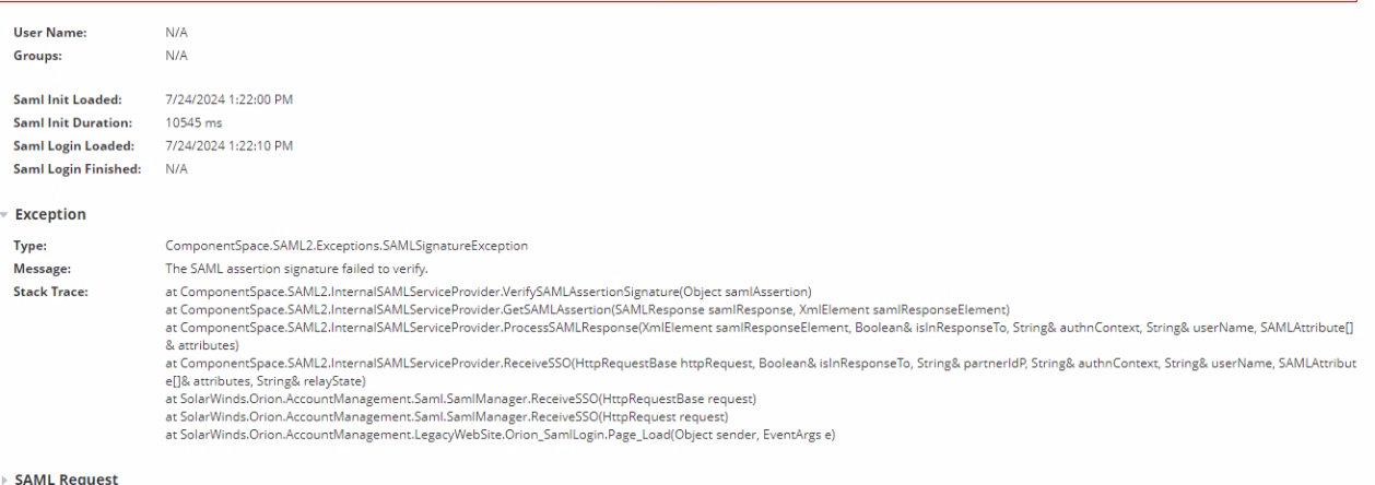

Error 3:
Assertion Signature invalid

  3. Incorrect Cert(extra spaces/chars)

Solution for Error 3:
Validate the IDP Cert in SSO configuration, remove and re-add if required.
