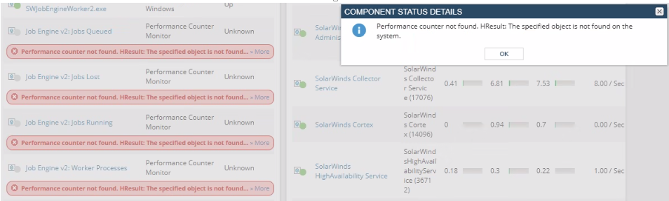

After the upgrade to 2025.4, the Template 'Orion Observability - Main Polling Engine' and 'Orion Observability - Additional Polling Engine' is shown as unknown due to missing counters.
Server Application Monitor
The SolarWinds JobEngine V2 category is no longer available on the Performance Monitor. It has been replaced with the SolarWinds Job Execution Engine V2.
Affected components are listed below.

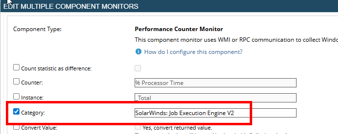

  • Open the Application and press the Edit Application
  • Select the Components
  • Click Multi Edit
  • Check the Category and Input the SolarWinds: Job Execution Engine V2

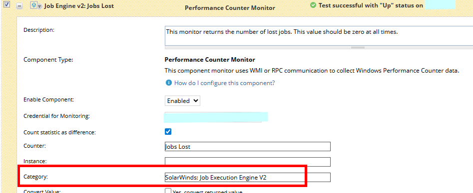

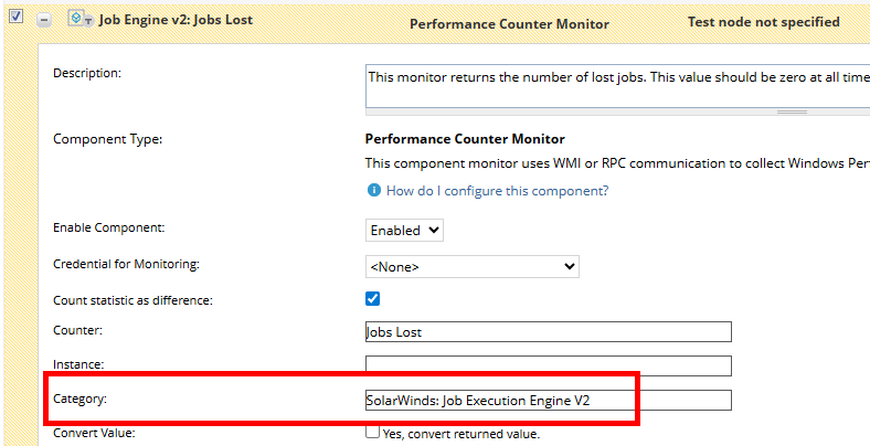

  • Then SAVE it after the update.
  • The result should look like the below:
  • It can be tested or saved before testing.
  • Navigate to the bottom, then 'SUBMIT' or 'Save and continue working' the changes afterwards
