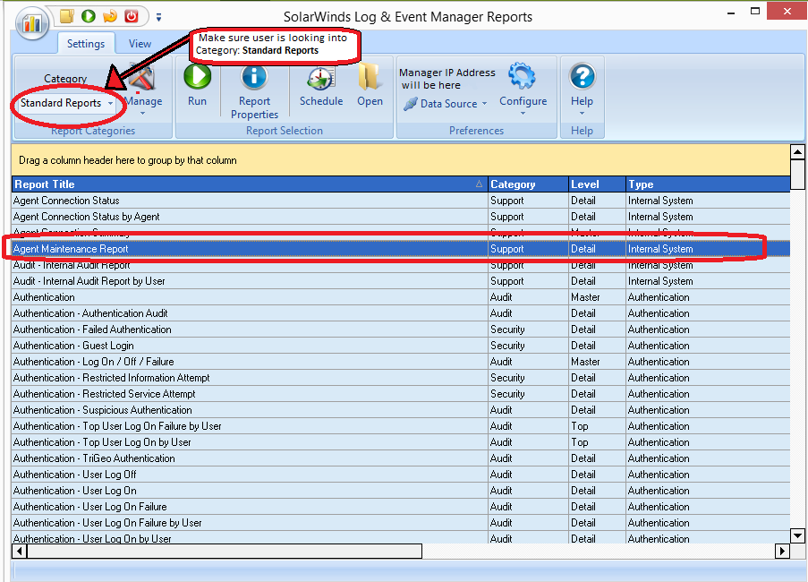

  1. Open the reports console.
  2. From the Category drop-down list, select Standard Reports. Report titles for the out-of-the-box standard reports are listed.

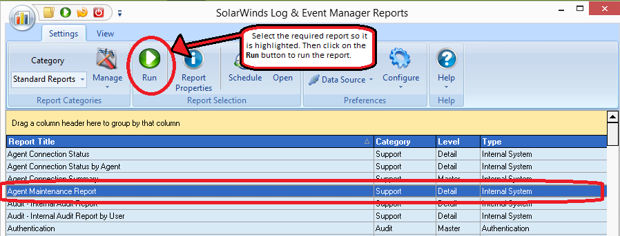

  3. From this list, locate the reports that the technical representative has requested. In this example, we have selected the Agent Maintenance Report.
  1. Select the report, and then click Run.

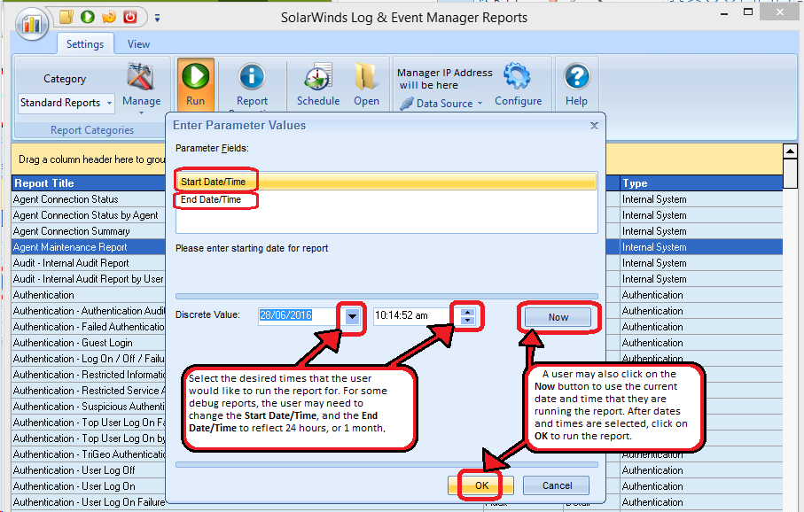

  1. You can select the time frame that the report should run by changing the Start Date/Time and the End Date/Time. For example, if you are looking for a report to give data on a month's time period, then make sure a month time frame is selected from Start date/time, to the End date/time.
    • Alternatively, for the End Date/Time, you can click Now to have the current date and time selected (also can be done for the Start date/time).
  1. After clicking OK, allow for some time for the report console to gather the requested information. Once it is collected, the report is generated.
