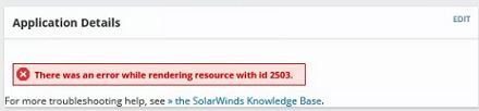

"There was an error while rendering resource with id XX" in the Orion widgets
How to solve the problem in the Application Details resource if the following message appears when using AWS: There was an error while rendering resource with id xx This error can also appear in other resources as well. This article suggests resolutions to all scenarios.

This article explains how to solve the problem in the Application Details resource if the following message appears. This includes environments on AWS and on-premises.
