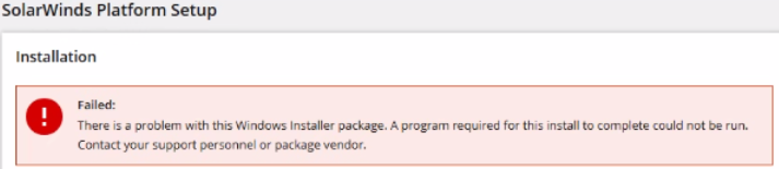

During the installation of the SolarWinds Platform, users may encounter Error 1721, indicating a problem with the Windows Installer package. This error specifically arises when the installer attempts to remove the Oracle ODBC driver but cannot run the required uninstall executable. This problem typically occurs on the server where SolarWinds is being installed and affects administrators or IT personnel responsible for the installation. The failure halts the installation process and can result in the SolarWinds Web Console failing to launch, impacting monitoring and management capabilities.

  • The Windows Installer attempted to run a custom action to uninstall the Oracle ODBC driver but failed because the uninstall executable (odbc_uninstall.exe) could not run properly.
  • This failure prevents the installer from proceeding because it expects the Oracle ODBC driver to be cleanly removed before continuing.
