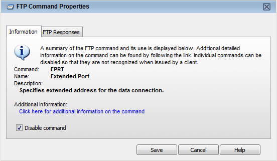

  4. Double-click the EPRT command, select Disable command, and then click Save.

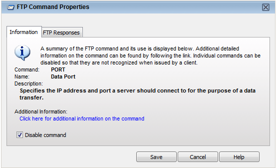

  5. Double-click the PORT command, select Disable command, and then click Save.

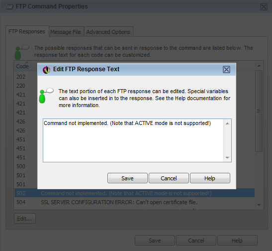

  6. Click Global Properties at the bottom of the FTP Settings tab. This will open the FTP Command Properties tab.
  7. Double-click the 502 - Command not implemented entry. Change the text from "Command not implemented." to either "Command not implemented. (Note that ACTIVE mode is not supported!)" or "Command not implemented. (ACTIVE mode is not supported - use PASSIVE instead!)" Then click Save.
