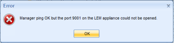

Reports Tool - Manager ping OK but the port 9001 on the LEM appliance could not be opened for SEM
This article provides steps on how to fix Reports Tool error stating "Manager ping OK but the port 9001" post enabling TLS on SEM.
10/19/2022 11:10 AM
2/12/2025 1:42 AM
Once enabletls command is executed and TLS is enable via CMC console.
While configuring SolarWinds Reports tool, it will show below error due to a missing .crt of .pem certificate within the Reports tool.
Security Event Manager
Missing Certificate files on Reports Tool.

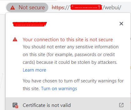

  • Or download a SEM .pem file via a web browser console.
    • https:\\<SEM IP>\ > Click "Cerificate is not valid" and export sem-lab.crt file. (names could vary as per user deployment environments)

At this stage, "Test connection" button will still result in the same error, but you will be able to run the reports without any issues.
