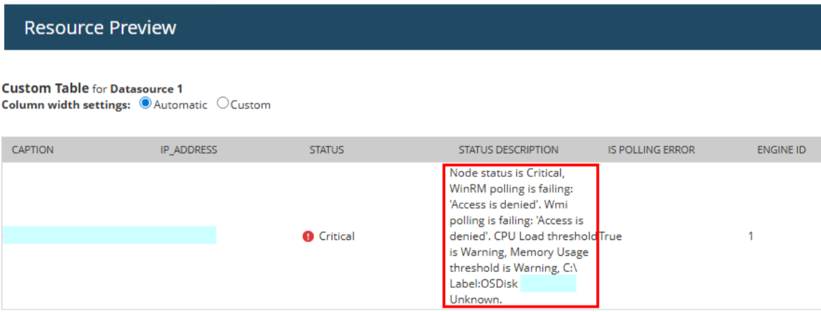

In SolarWinds Platform 2026.1, node status can change to Critical or Misconfigured when core SNMP, WMI, or WinRM polling fails repeatedly, even though the device still responds to ICMP (ping).
Examples:
  • Node status is Critical, SNMP polling is failing: 'Request timed out - possible causes include network issues, incorrect community string or SNMPv3 credentials, or device not responding.'
  • Node status is Misconfigured, Wmi polling is failing: 'The user name or password is incorrect.'
Internally, these nodes are also flagged with a property that indicates a polling error. Instead of clicking each node individually, you can create a report that lists all such nodes in one place, with the most important fields on a single screen.

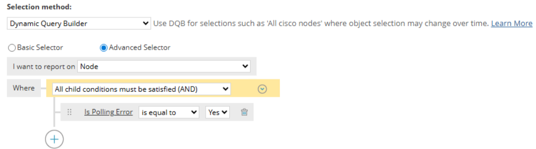

4. Filter the table to only show nodes with polling issues
Still in the Custom Table wizard, configure the Filters:
  1. Add a filter row for “Is Polling Error”:
    • Is Polling Error is equal to True

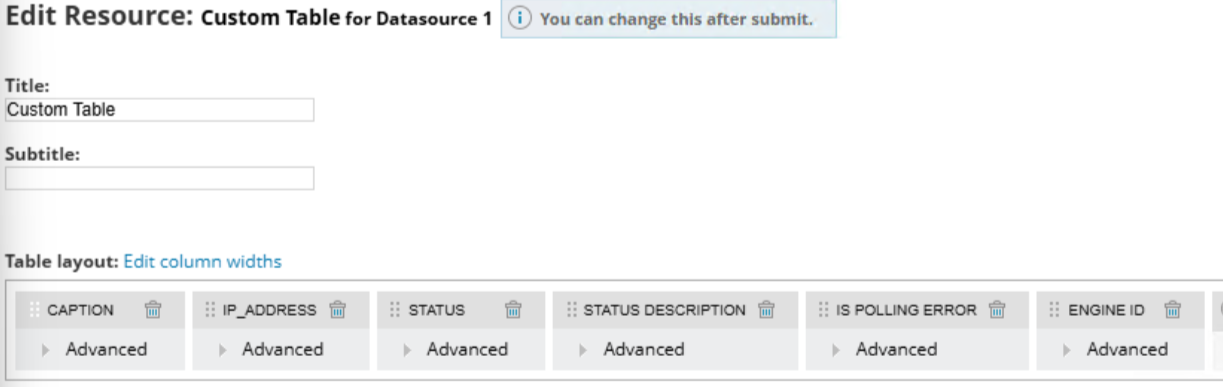

    5. Select and arrange the columns
    In the Columns step of the Custom Table:
    1. Add the following columns (names may differ slightly by version):
      • Environment
      • Site / Location
      • Region
      • Owner / Business Unit
      • Caption (or Node Name)
      • IP Address
      • Status
      • Status Description
      • EngineID
      • Any custom properties you use for grouping or ownership, such as:
    2. Arrange the columns in an order that makes sense for your operations team, for example:
      1. Caption
      2. IP Address
      3. Status
      4. Status Description
      5. EngineID
      6. Environment
      7. Site
