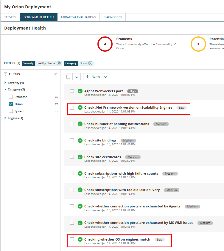

Run tests in the Orion Web Console (Deployment Health)
You can verify OS and .NET Framework versions directly in the Orion Web Console. In Deployment Health, there are two separate tests:
  • Check .Net Framework version on Scalability Engines
  • Checking whether OS on engines match
To view the test results:
  1. Log in to your Orion Web Console using an account with administrator privileges.
  2. Click Settings > My Orion Deployment.
  3. Click Deployment Health tab. By default, only problems and potential issues are displayed. If you cannot see either of the tests, both .Net Framework and OS versions on polling engines match.
  4. To see more details, find the tests. You might need to clear the Severity Filters.
    • To re-run a test, select it and click Refresh.
    • To see results of the test, click the arrow at the end of the test row.
Learn more about troubleshooting your deployment with Active Diagnostics in the Orion Web Console.

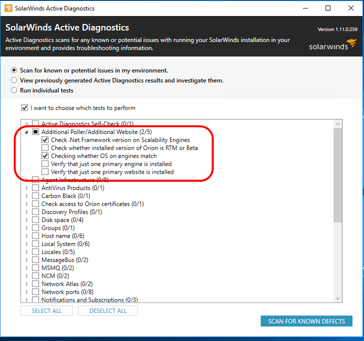

Run the Active Diagnostics app
  1. Log in to the server hosting your main polling engine.
  2. Start SolarWinds Active Diagnostics  (Start > SolarWinds Orion > SolarWinds Active Diagnostics).
  3. Select Scan for known or potential issues in my environment.
  4. Expand Additional Poller/Additional Website, and select Check .Net Framework version on Scalability Engines and Check whether the OS on engines match.
  5. Click Scan for Known Defects.
