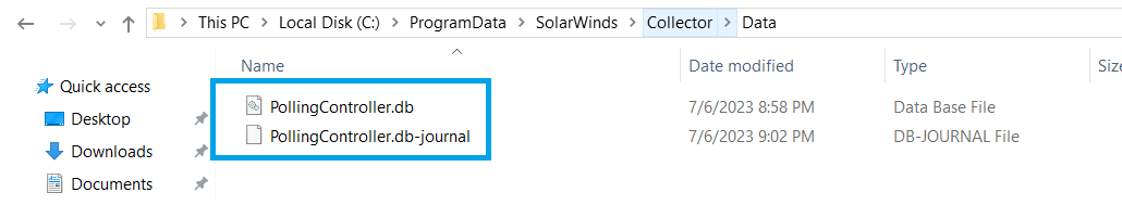

Collector:
1. RDP to the Orion Server.
2. Stop the SolarWinds Collector via the Orion Service Manager on all Orion servers.
3. Navigate to C:\ProgramData\Solarwinds\Collector\Data.
4. Delete the PollingController.db and PollingController.db-journal files.
5. Start the service once more via the Orion Service Manager.
6. The files will be rebuilt automatically.

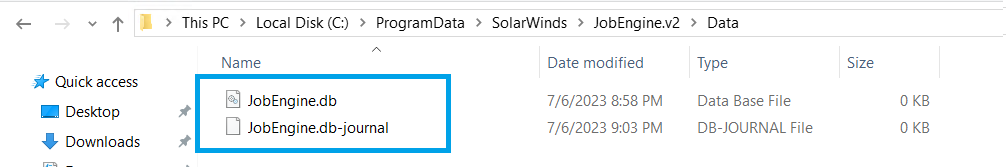

Job Engine:
2. Stop the SolarWinds Job Engine via the Orion Service Manager on all Orion servers.
3. Navigate to C:\ProgramData\Solarwinds\JobEngine\Data.
4. Delete the JobEngine.db and JobEngine.db-journal files.
