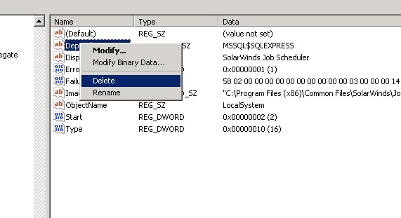

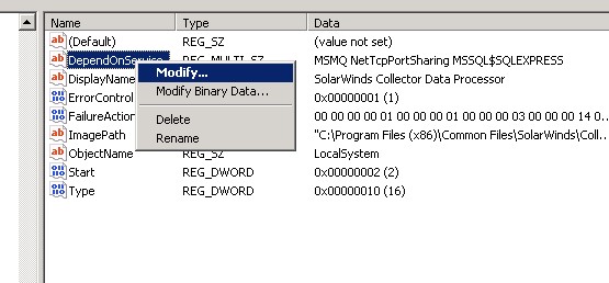

  3. Under HKEY_LOCAL_MACHINE\System\CurrentControlSet\Services, find the dependent services for which you would like to remove the dependency. See the screenshot - relevant services are all services between SWCollectorDataProcess and SWJobSchedulerSVC excluding SWenum.

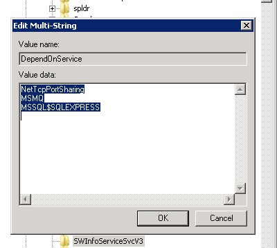

  4. Right-click the string value DependOnService and select Modify.
  5. Delete the service that to remove the dependency from, which will be MSSQL$SQLEXPRESS.
  6. Remove the dependency for that service from each of the services and then delete the DependOnService from SWJobSchedulerSVC because it only has a dependency on SQL.

You'll notice there are some SolarWinds processes that include dependencies in addition to SQL server process. In those cases it's probably wise to keep those defined. Make a note what the other dependencies are and reapply them using the SC command, while leaving out the SQL server process.
For example, the dependencies of 'SolarWinds Collector Data Processor' originally included: 'Message Queuing', 'Net. Tcp Port Sharing Service' and the' mssqlserve' process.
I used the following:
     run sc config "SWCollectorDataProcessorSvc" depend= "MSMQ/NetTcpPortSharing"
Note that multiple dependencies are defined using the '/' as the separator with no spaces and the actual service (not display) names are used.
