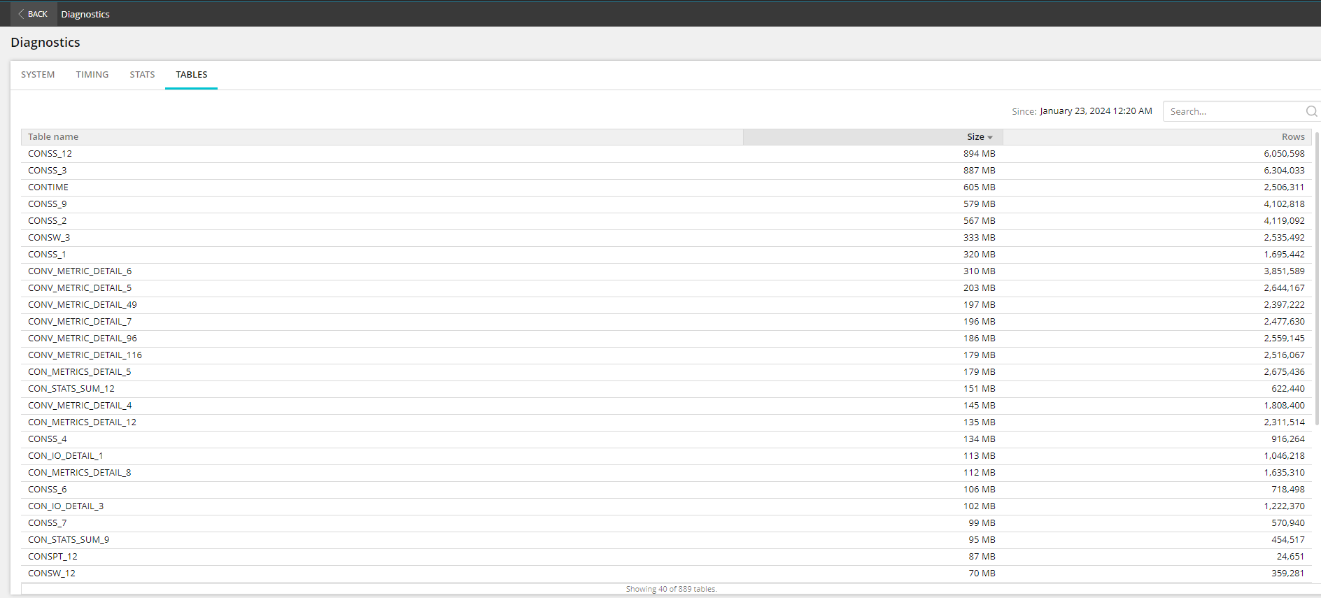

Starting in DPA 2022.3 there is a location to see the table sizes for the DPA repository in the DPA Options page. Navigate to the support section Diagnostics page found in the lower left then click on the tables tab.
This data is also in the log files sent. In a support log file zip  the files are in dpa\diagnostics\repositoryTablesInfo.log
