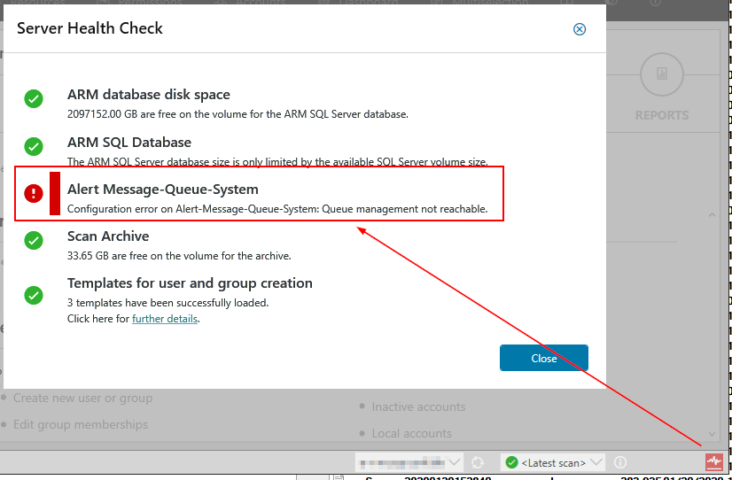

SCENARIO 1
Access Rights Manager (ARM) utilizes RabbitMQ for alerting purposes and requires specific users to be configured. You will notice some issues with ARM-RabbitMQ communication in the Server Health Check
Upon checking ARM Server log (c:\ProgramData\protected-networks.com\8MAN\log\armServer.log) you will notice below
Error creating a Connection to 'amqp://HOST:5671' for user 'arm_client' on virtual host 'arm'. Error: RabbitMQ.Client.Exceptions.BrokerUnreachableException: None of the specified endpoints were reachable ---> System.IO.IOException: Unable to read data from the transport connection: An existing connection was forcibly closed by the remote host. ---> System.Net.Sockets.SocketException: An existing connection was forcibly closed by the remote host

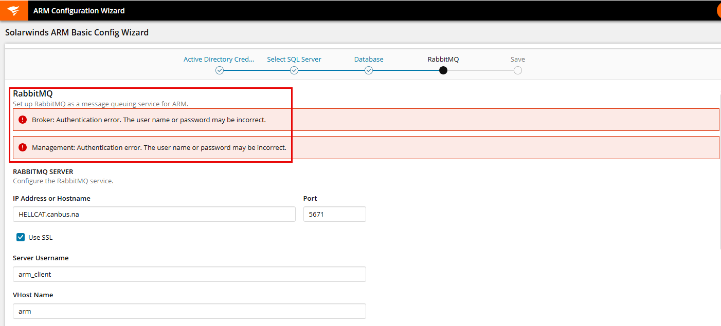

SCENARIO 2
Iif you see the following error in the ARM Configuration Wizard, as you cannot reset the RabbitMQ account passwords in ARM 2025.4 and later
You will see the following error twice in the RabbitMQ section of the Configuration Wizard, and will be unable to save the configuration:
Broker: Authentication Error. The username or password may be incorrect
As you can no longer modify the existing account passwords, you need to follow the steps below in order to reset the accounts.
