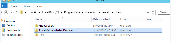

  3. Go to C:\ProgramData\RhinoSoft\Serv-U\Users
  1. Remove the "Local Administrator Domain" folder.

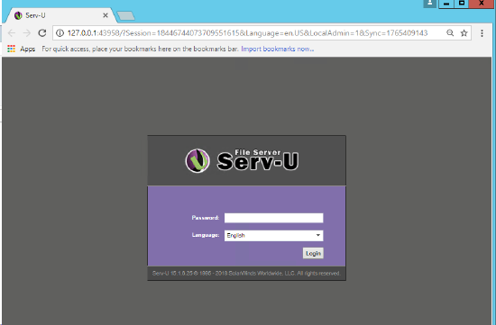

  3. Open Serv-U management console and log in to the Serv-U server.
You can now log in freely to the Serv-U Management Console.
