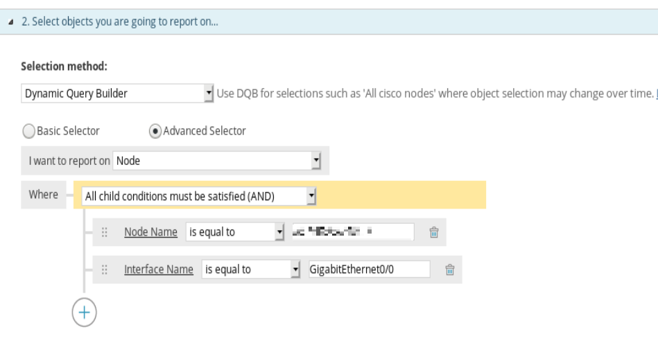

When customer creates a report with the following Datasource:

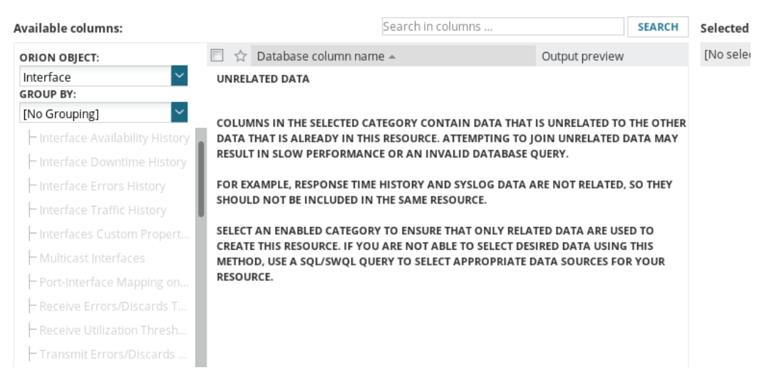

The following error will be encountered:

1. If you do a search on the tree (Under Nodes), you will notice an "Interface".
** Note that it is an NCM entity (if you have NCM installed)

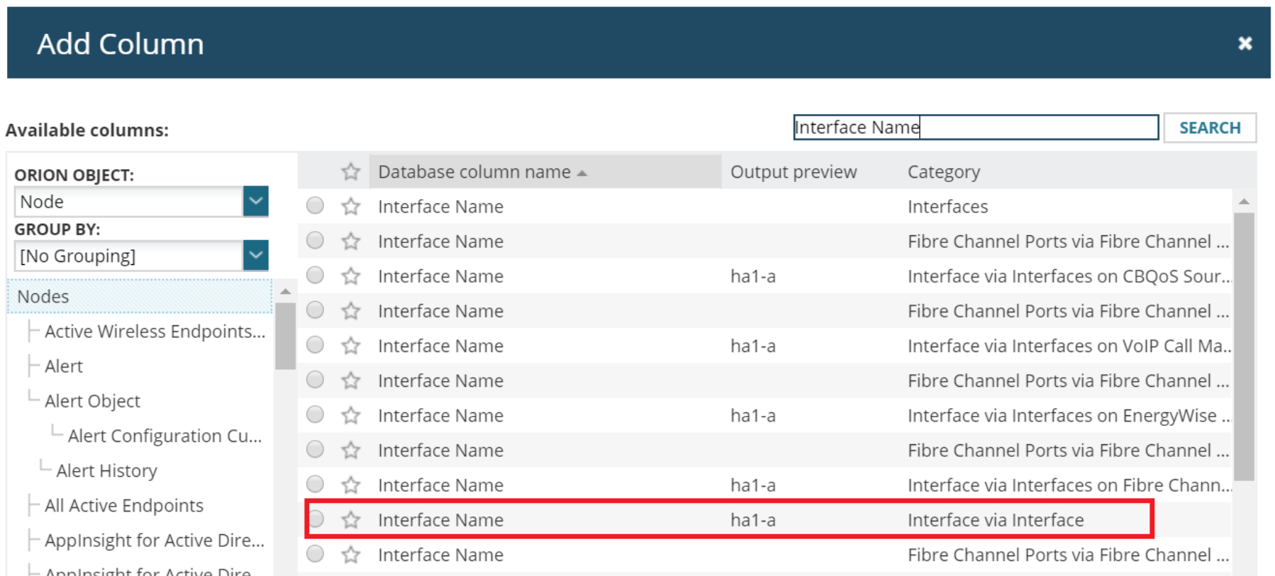

2. If you do a search in the Resource Picker when selecting the "Interface Name" for the Datasource, you will notice that there are many different variations of "Interface Name" across many different tables
The correct option that you should select is Interface via Interface.
