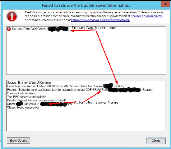

This article applies to deployments where an Automation Server was incorrectly deployed changed after being deployed. In this example, the Automation Server is incorrectly reported in the Patch Manager Administrator Console with inaccurate information.
You may see below errors in MMC error window and DGS logs
2018/08/08 11:22:30:914 PID: 7104 TID: 7948 [ERROR] ComputerViewControl::ExecuteEnumerateComputerTargetsQuery() failed. Message: Source: Data Grid Server (IDC-SW-PMNG02) Reason: Failed to send partitioned task to automation server ABCWSUS.mydomain.com. Reason: Communication failure. The authentication service is unknown. Details: dgsrpcinterface::createsession failed! Object: ABCWSUS.mydomain.comObject Type: wsusserver
2018/08/08 08:47:38:954 PID: 3080 TID: 2864 [ERROR] clientcertificatecache::initialize() - Unable find and load this servers certificate. Server is not provisioned and will not be able to communicate with downstream servers. 2018/08/08 08:47:38:954 PID: 3080 TID: 2864 [ERROR] clientcertificatecache::createthisserversfullsicspn() failed to find certificate for
