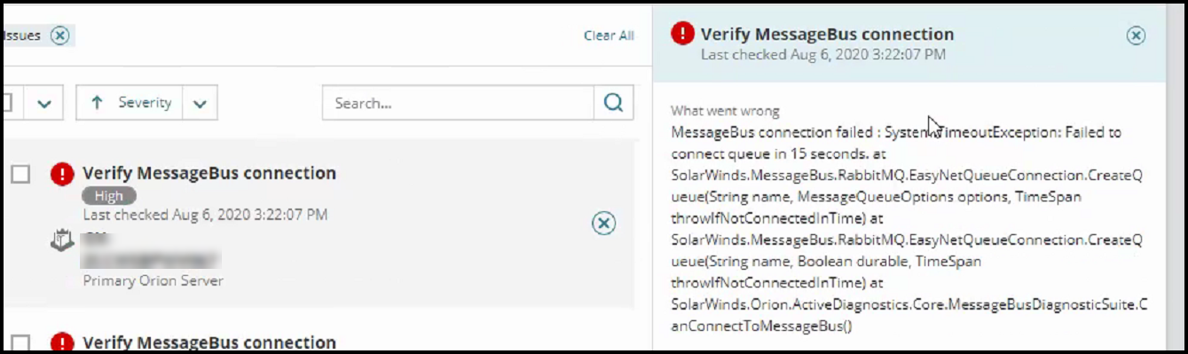

The deployment health page indicates a messagebus issue.
